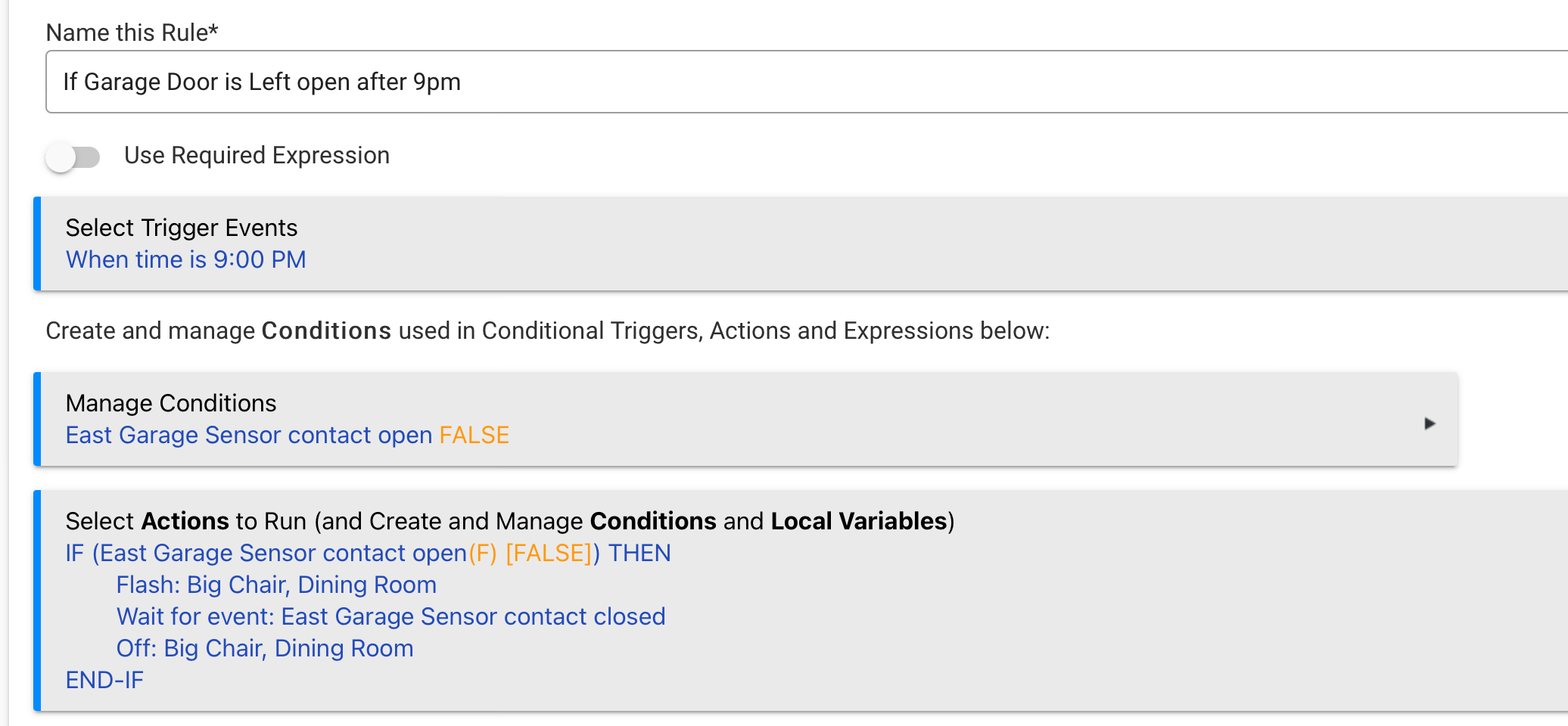

I think I figured out @Alan_F
As @TArman points out...I think I need to add something in here that triggers this rule to run say every 10 minutes in the event that someone comes home after 9 pm and forgets to close the garage door?
OR, if i leave the original rule does that handle the door opening after 9pm and being left open?

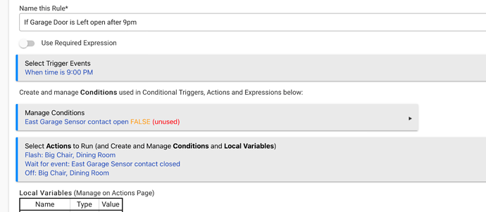

Closer, but you need to actually use that conditional in an if statement.
As it is now, the lights will always flash at 9pm.

Do tell...I'm a little lost on where to add or correct the conditional.
Add a New Action, then select the "Conditional Actions" option to create the If-Then statement. Since your condition is already defined, you'll be able to just select it to use as the conditional portion.
The documentation for Rule Machine is quite good - you should check it out.
Thanks @hydro311 I try to get into the documents but sometimes they are not clear to someone without "skills"
I do think that I understood what you said though.

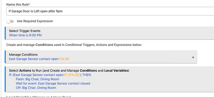

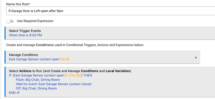

That looks good. Although it's not required in this particular case, I'd add an "End If" at the end -- it's always good form to close an If statement with an End If, and it becomes required in rules with nested Ifs, so might as well get in the habit of just doing it every time.
The end if jus tells the rule that there is no additional action or XX to come?
With the addition of the if statement inside of the actions can I remove the Manage Conditions statement above it? Seems repetitive.
It simply closes the If statement. You could now add any additional actions to the rule now, since that If stmt is properly isolated/contained (for lack of better words).
No, don't do that. That's just a listing of conditions used in the rule. If you remove the condition there, the rule will break.
A condition can be used more than once in a rule, so (among other things) that "Manage conditions" area makes it easy to update a condition without having to dig around in the rule itself.
You got it! Just takes a little practice and thinking ā€œlike a computerā€.
