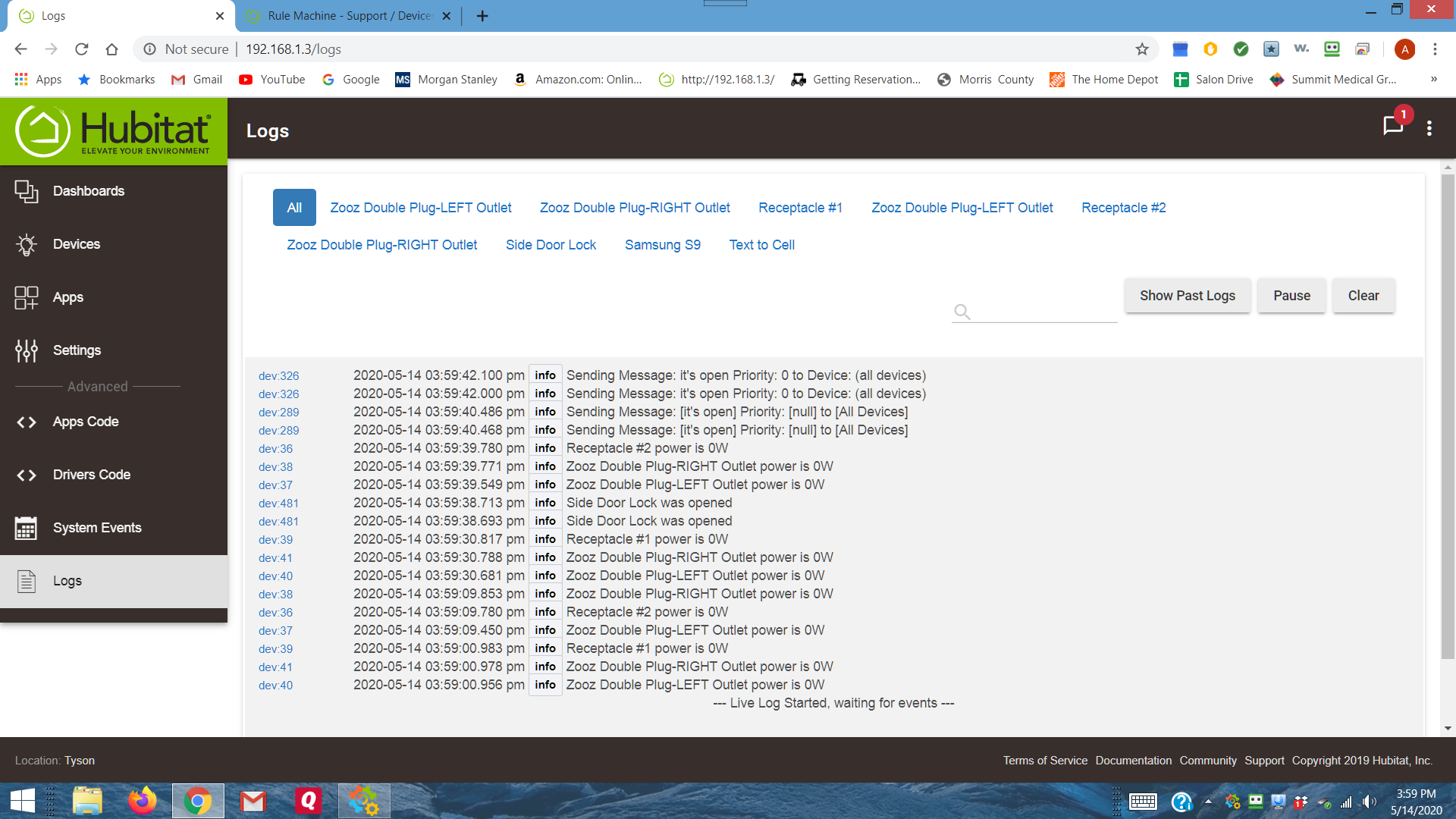

Also I did check the logs and nothing. The device does show up in the list.

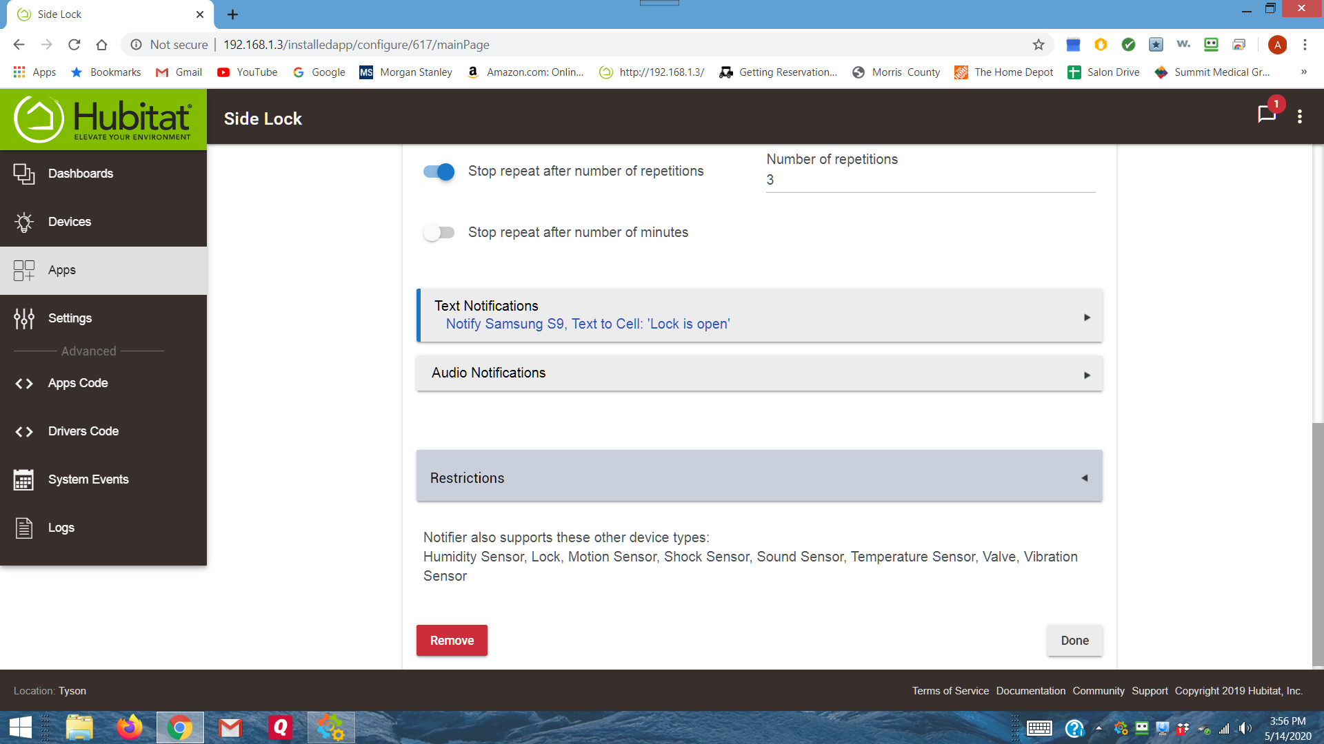

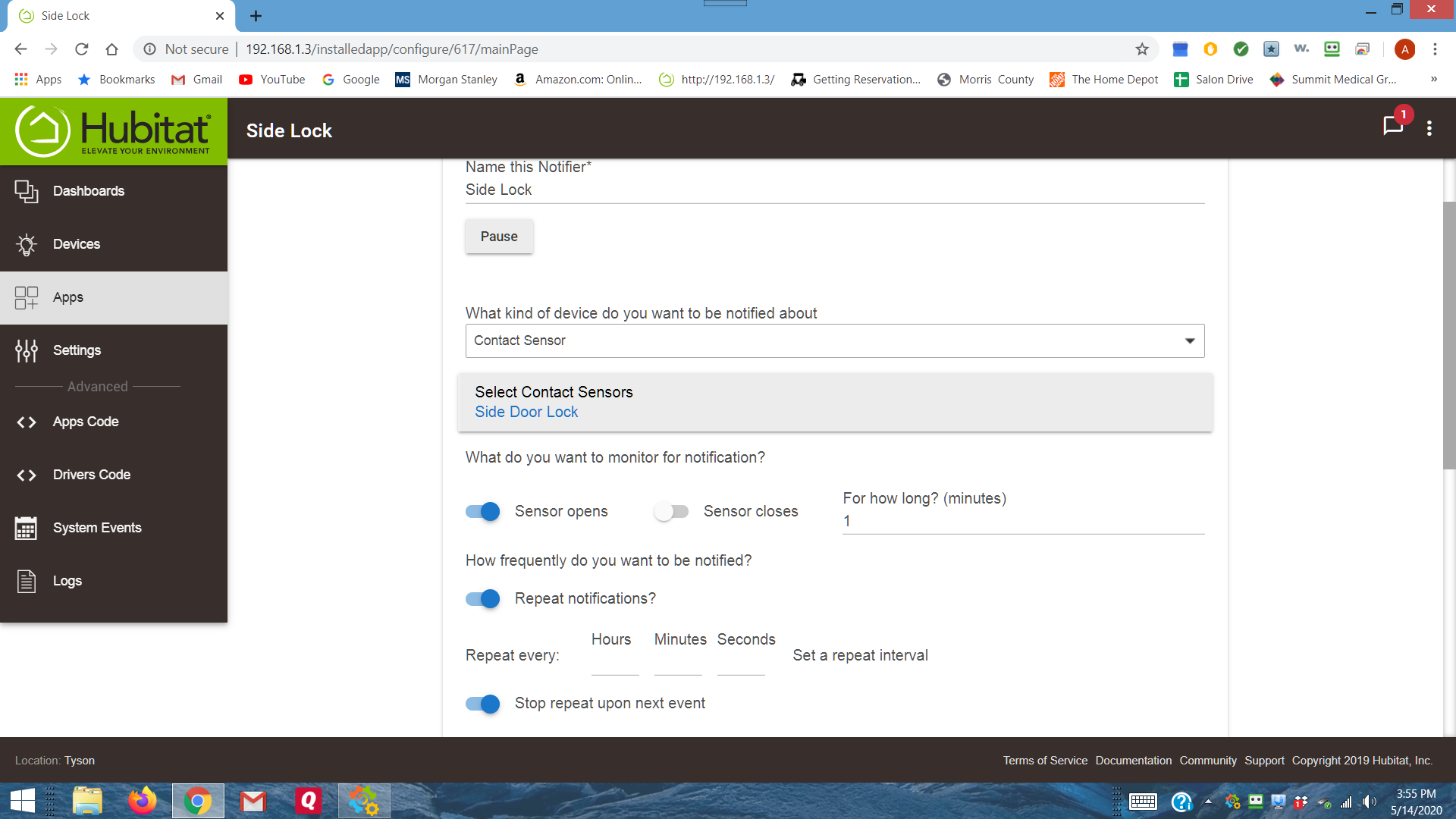

Here are screenshots of the app and logs? I can also see on the device that it changes from open to closed. I thought I would get a notification to my phone but no.
OK, so the screenshot is definitely the Notifications app, not Rule Machine. That's good. Everything also appears to be set up correctly, which is also good. My hunch is that the "Samsung S9" device isn't getting notifications. You can test this yourself by trying to send one manually:
