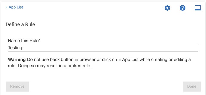

I have the latest firmware and a fresh C5 hub. I’ve installed rule machine and the child rule will not save after defining the name.
It just acts like it’s saving but never returns.
Any suggestions on how to fix this?

Perhaps we could see a screenshot of the Rule just before you try to save? Rule Machine has a bunch of states that it goes through as actions, triggers, conditions, etc., are defined, and won’t let you proceed until you have done what it wants. Or, perhaps this is something with a weird character in a variable name (there is a recent bug on that).

Still exists, it’s just not something that I think is going to get resolved without the help of support. I just found I can work around it by navigating to applications while it’s still trying to save. When I do that the name doesn’t show up for the rule, it just says Rule-4.1. If I edit that rule everything is there and saving the changes again let’s me move forward.
No errors and nothing in the log.

I’m not even getting to the point where I configure the trigger. I am just assigning a name in the name field. The other information isn’t even populated yet.
