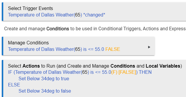

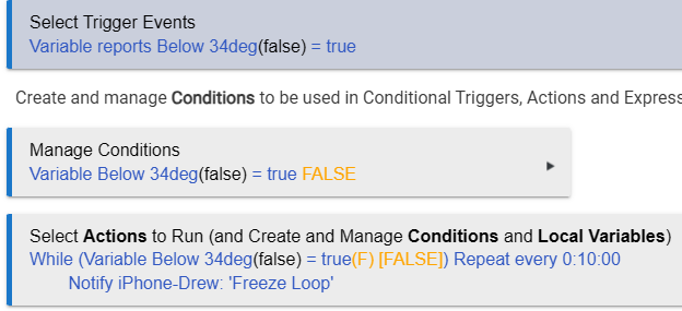

Ok...I think I have a good solution here.
"Below 34deg" is the name of my Boolian Variable. I have one rule that will set it true/false depending on the temp. (In this test, I used 55degrees since it isn't that cold yet here in Dallas). Here is that rule:
Then, I have the loop rule. Right now my only action is just to send me a push notification to my phone. But this is just a proof of concept. I'll add my actual actions later:

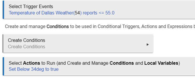

I can make 2 rules like this so that it will go back to false when

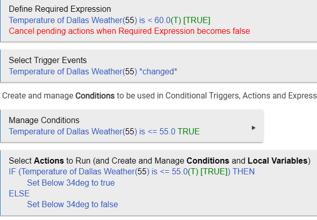

So you are saying leave my rule as it currently is but adding the Reqd exp portion will limit it to "winter months" for when it runs?
Like this: (again...im using warmer temps for testing purposes)
