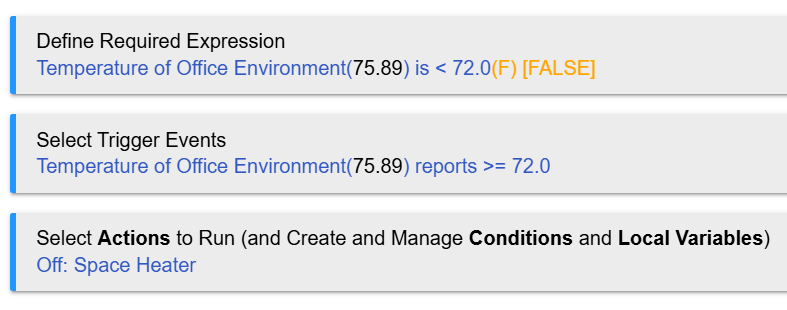

Will this work? I'm essentially looking to replicate the "on transition" behavior in SharpTools:
By "work" I mean: when and only when the temperature (poll) changes from 71.9 or lower to 72.0 or higher, the rulle will trigger and "Space Heater" will turn off.

For my own learning purposes. Can someone explain how this will work? The way I read it is that the trigger will never happen as the required expression is false. If the temp hits 72, the trigger point, the required expression will be false and therefore will not trigger, right?
I think you are correct that the rule will never trigger (and I have since removed the required expression). Thanks, everyone, for the suggested alternatives - I'm looking into both the polling on the temp monitor and a boolean on the switch.

Change your required expression to include your temperature requirement and for the space heater to be on.
It should actually work as the OP expects, due to the order in which triggers and required expressions are evaluated. There have been many posts about this as the behaviour seems counterintuitive at first.
If you want to verify the behaviour for yourself, create a virtual temperature device and use it to trigger the rule with logging enabled, and watch the logs for the rule as you change the temperature on the virtual device.
It's false now (well, when the screenshot was taken) because the temperature is >= 72. That's actually exactly what the OP wants: it will prevent the rule from triggering when this is the case. On the other hand, when below 72, the expression will be true, allowing the rule to trigger -- once (until the temperature again goes below), also exactly what is desired.
This rule should work as intended, in other words. This very kind of specific transition is one of the use cases this feature was added for, as the OP also found in the docs. This is essentially the same as the mode example, just a different event.

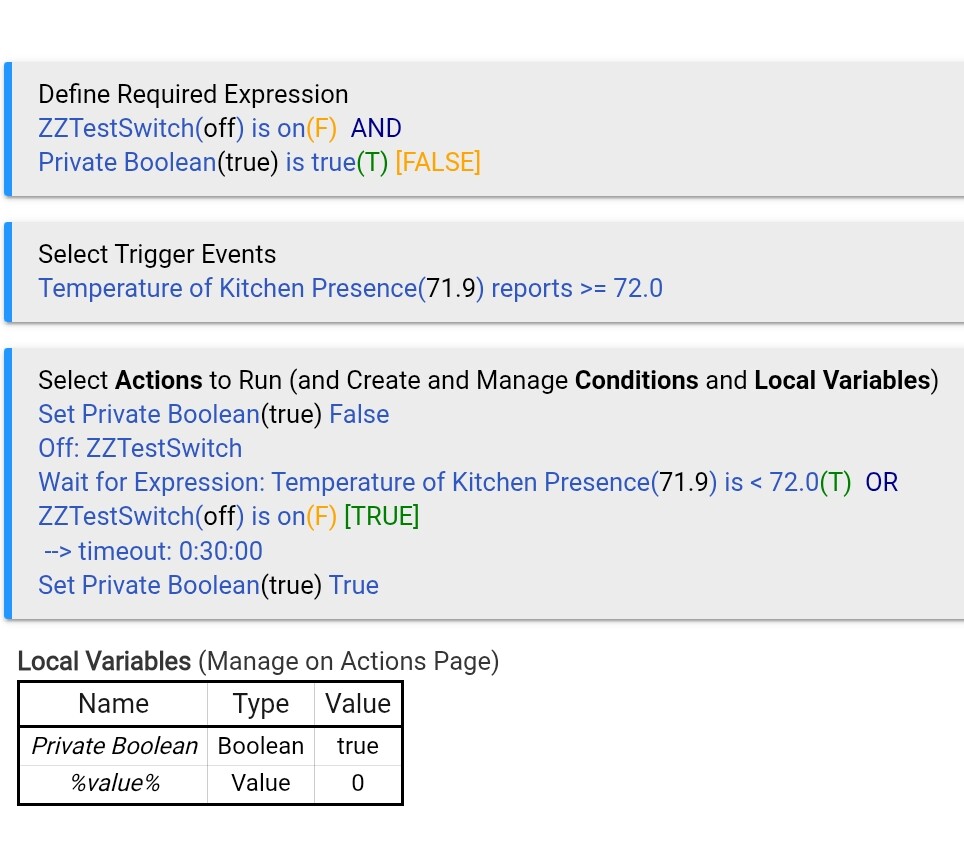

This is how I would do it if it were me using private boolean to prevent it from running again until the switch turns back on, the temperature drops below the threshold, or 30 minutes has elapsed. Adding the switch to the required expression also prevents it from checking if the switch isn't already on.
I'm not following. The Required Expression and the Trigger Event are testing the same value in this case. When the event triggers, the required expression is checked. But the temperature at the time of the trigger can never meet the Required Expression (< 72.0) and what triggered it (>= 72.0) at the same time.
Doesn't Required Expression get evaluation upon the trigger event only? That is, a change in the truth of the required expression is not a trigger. But a trigger is required for the Required Expression to be considered.
Yes and no
In general, the required expression gets evaluated upon receiving events for which it is subscribed. Same for triggers. This is a special case where both required expression and trigger depend upon the same event, and therefore order of evaluation matters.
It so happens that the trigger evaluates before the required expression for the same event, therefore in this case at 72 the rule will trigger and shortly after the required expression will turn false and drop all trigger subscriptions. When the required expression is false, there is no ambiguity: only the required expression is subscribed, and triggers will be re-subscribed only after it turns true.
@bertabcd1234 might know more about it, but I see it as a design choice, and a good one IMO, as it allows representing these "edge-triggered" use-cases simply.
I appreciate that explanation. If I'm understanding correctly, the special case of the required expression and trigger being the same, the logic is that the required expression was true at the instance of time just before the trigger event occurred. That is, the trigger event notwithstanding, the required expression was true when it .. well .. started to occur.
So I get it. It also helps to read Bruce's explanation here:
Not quite. Think of it like the docs say: the value of the required expression at the moment just before triggering (i.e., any change that might happen as a result of the trigger event won't yet matter). So if the temperature 71, the required expression will be true. If it becomes 73, the rule will trigger. Then the required expression will become false, and it won't be eligible for triggering until the required expression is again true.
The use @hubitrep mentioned is one of the reasons this feature was introduced, capturing specific state changes (in this case, below and above a threshold; in the docs example, one specific mode to another -- that would never work if evaluation worked differently).
Well, I should have looked more closely at the logs. It does seem to work as intended:

Just following up here to confirm that the rule as illustrated in the original post is indeed working as expected.
I've also adapted it to other rules - all temperature based. Required Expressions are handy in a few different ways (e.g. Modes), but they seem especially useful whenever a temp threshold is invovled in the rule's logic - even though it's not really immediately obvious (or at least wasn't to me). I wonder if including an example in the docs would help Hubitatians get more mileage out of them.
