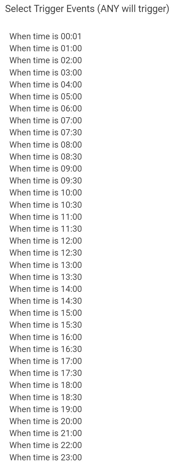

I have the following Rule Machine (5.1) Trigger event:
The trigger was working correctly until 7/10/2022 when the 6:00, 7:00, 7:30, 13:00, and 13:30 triggers weren't getting triggered.
On 7/13 I tried deleting those triggers and added new triggers at the end. Once I did that, 3:00, 4:00, 5:00, 13:00, and 13:30 weren't getting triggered.
On 7/14 I tried deleting all of the triggers, and adding them over again. Now 1:00, 2:00, 14:30, 15:00, and 15:30 aren't getting triggered.
I've tried updating to the latest version of HE several times, but that didn't help.
Any ideas what is going wrong with my trigger?

I checked the Trigger and Action logs this morning. The rule was triggered and the actions ran at 00:01 and 3:00, but skipped 1:00 and 2:00. Below is a copy of the log. Any additional thoughts on why the trigger time values are being skipped?

@bertabcd1234 You recommended looking at the "Scheduled Jobs." Here is the list:
Handler, Next Run Time, Prev Run Time, Status, Schedule
|allHandlerT|2022-08-03 21:00:00 CDT|2022-08-02 21:00:00 CDT|PENDING|0 0 21 * * ?|

From that, the missing trigger times aren't showing up in the scheduler either. Let me know if that helps determine any next steps.
