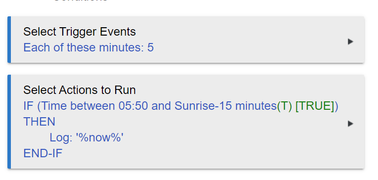

No matter what, and including post soft reboot and full power reboot, this rule always evaluates to true as if RM is using the Sunrise time as a pure value and seeing that its between 05:50 today and .

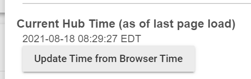

System clock, TZ and location/sunrise information for the hub have been verified.

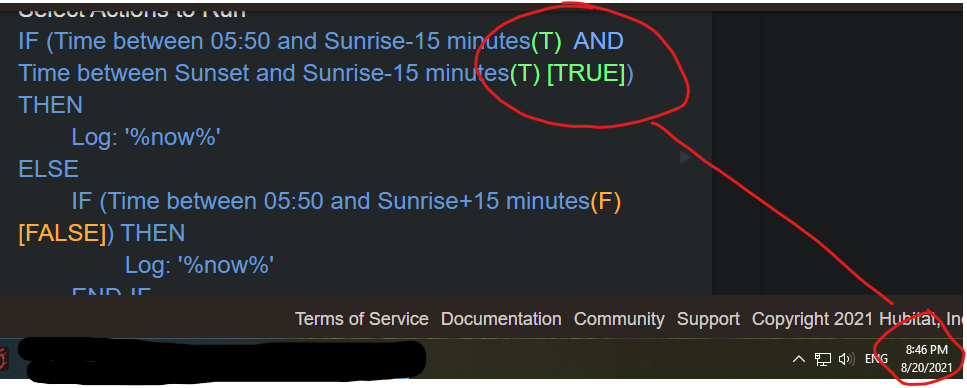

Adding an extra check, this seems to happen whenever sunrise-X is before of the condition... question then becomes how to write a Rule that correctly acts only when the time is actually between X and some sunrise-15 that is and works all year round...

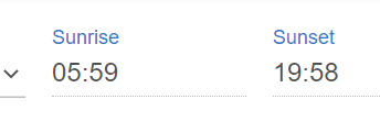

Time now 14:55
Sunrise is at 6:30
I get the following:
There must be some logic in there, somewhere :slight_smile:
The condition will be true if you're after the first time, but before the first sunrise following the first time...
You could add an AND condition: Time between Sunset and Sunrise - 15 minutes

Sadly.... no.
Hi…. My apologies, maybe I’m just not understanding the use case but why create a trigger for your hub every 5 minutes?
Have you tried just starting over with a simpler approach and just making sunrise your trigger?
Assuming I am not completely misunderstanding what you’re trying to do, once you can confirm a simple sunrise trigger fires off correctly and consistently first then you could apply additional layers of complexity/logic as needed one piece at a time so if anything breaks you know it’s whatever the latest addition was.

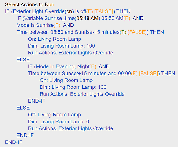

I want my lights on from 5:50 until sunrise-15 and from sunset+15 until midnight, unless overridden. If sunrise-15 is <= 5:50, then it’s bright enough outside that I don’t want them on.
If the trigger is sunrise, then the sun is already up, and that’s after I need/want my lights on :slight_smile:

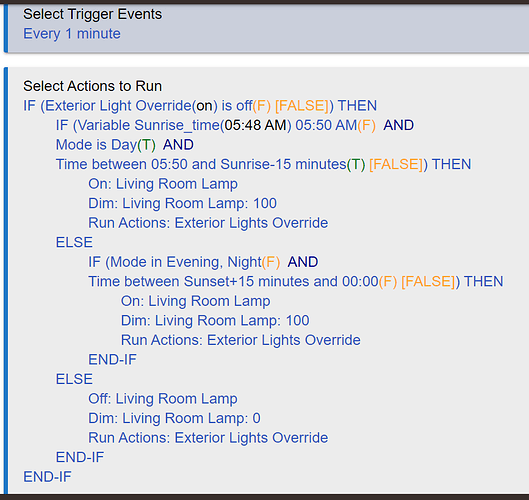

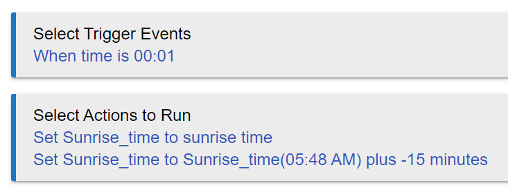

For reference, here is the whole of my use case:
Set global variable sunrise_time at 00:01:
Override rule:
Actual light control rule:
I think that last iteration of my use case actually "solves" the problem, just inelegantly. :slight_smile:
What we would "need" is a way to reference sunrise today. I tried setting a global datetime variable, but the variable compare in RM ignores the date portion of it.

Cancel that celebration lol. I got ahead of myself. That will still trigger after sunrise-15 once sunrise-15 is after 5:50 and mode is day... meaning my lights would stay on all day.

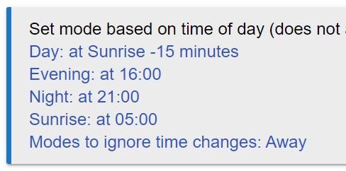

Ok, so I added a new mode, Sunrise, which starts approximately at the earliest listed sunrise for my location:
and updated the rule to only trigger in that mode. Assuming the Mode Manager correctly set mode to Day @ sunrise-15, then that will escape the rule at that point:

With the new mode, I can probably have the mode start at 5:50 and reduce the condition to two checks:
"If variable >= 5:50" AND "If Mode is Sunrise"
I think using Wait for actions, even if cancelable, removes the ability to override the current condition of the lights in a way that returns them to their scheduled mode.
The override switch I'm flipping is tied to the other app that resets the switch for 15 mins; this has two net effects:
First, anyone changing the lights will only override them for 15 minutes, and second, even the main rule can only affect their state once every 15 minutes - to prevent them coming on at 5:50 and turning off at 5:51 or some such variation :slight_smile:
