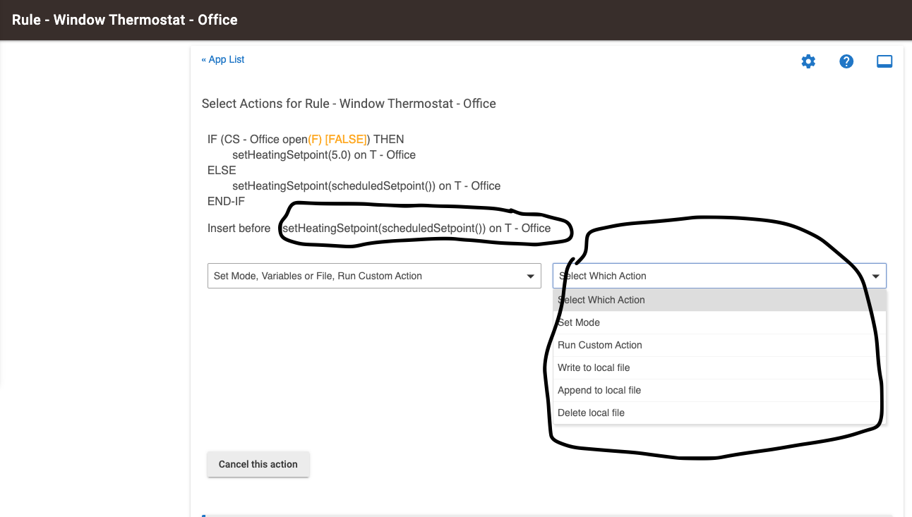

Hmm, unless I am looking in a wrong place, I don't seem to have an option to 'Set Variable' in my dropdown.

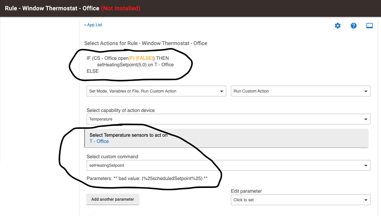

I've also tried 'setHeatingSetpoint(scheduledSetpoint()) on T - Office' but was only able to set the 'setHeatingSetpoint' variable to 'scheduledSetpoint()' as a string, which obviously doesn't do anything...

Those are not variables -- they are device attributes. In RM you can put one of those values into a local or global RM variable, and would need to do so to do anything with it.
EDIT: Never mind, I'm an idiot. Was picking a wrong device. Let me try that -- I think I'm getting somewhere. Thanks for bearing with me.

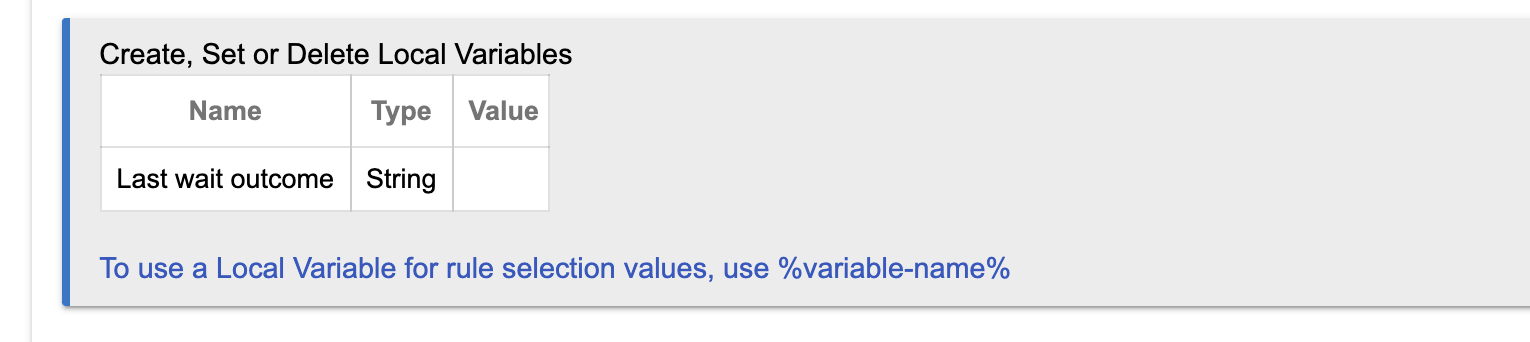

I just deleted a message detailing how I was still not figuring out how this local variable stuff worked when I finally found the post I had found previously that reminded me I actually need to READ the screen. That whole "Create Local Variable" thing that shows up at rule creation. Pretty self explanatory. Y'know... if you read it.... sigh.... my brain....
