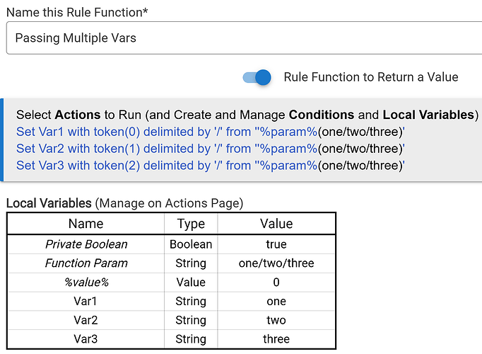

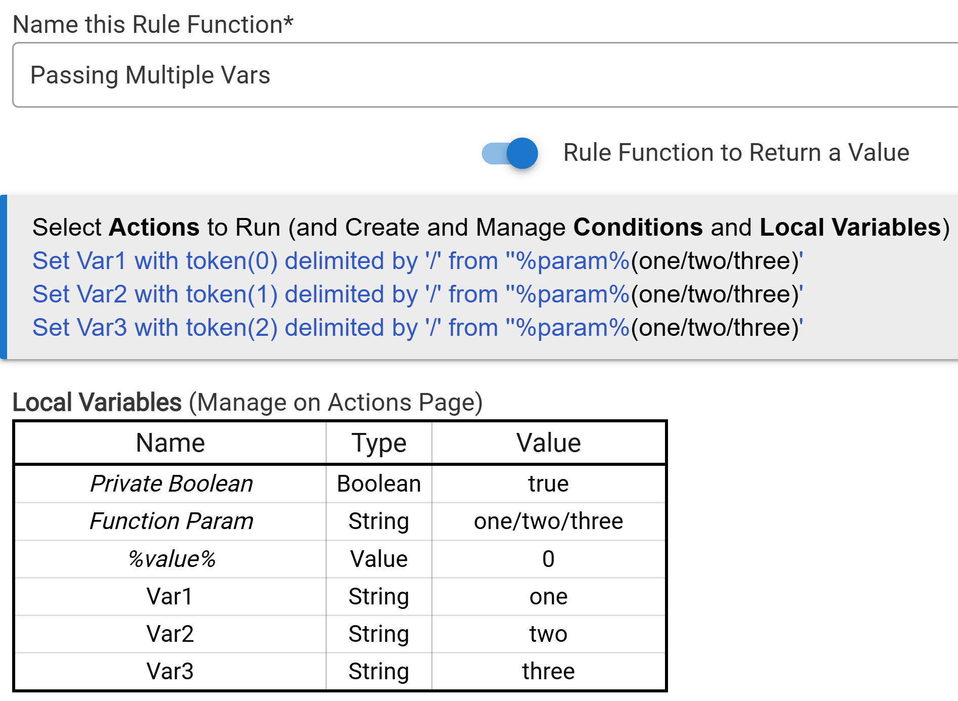

It would be nice to be able to pass more than one parameter to a rule function in some future release :slight_smile:
Already possible AFAIK
Yeah, I'm doing it that way now. Problem is figuring out a delimiter that is never used in the param. I'm calling a function where the param can really be any string.
Rule Mach is perfectly happy using emojis (think: )for the delimiter.
