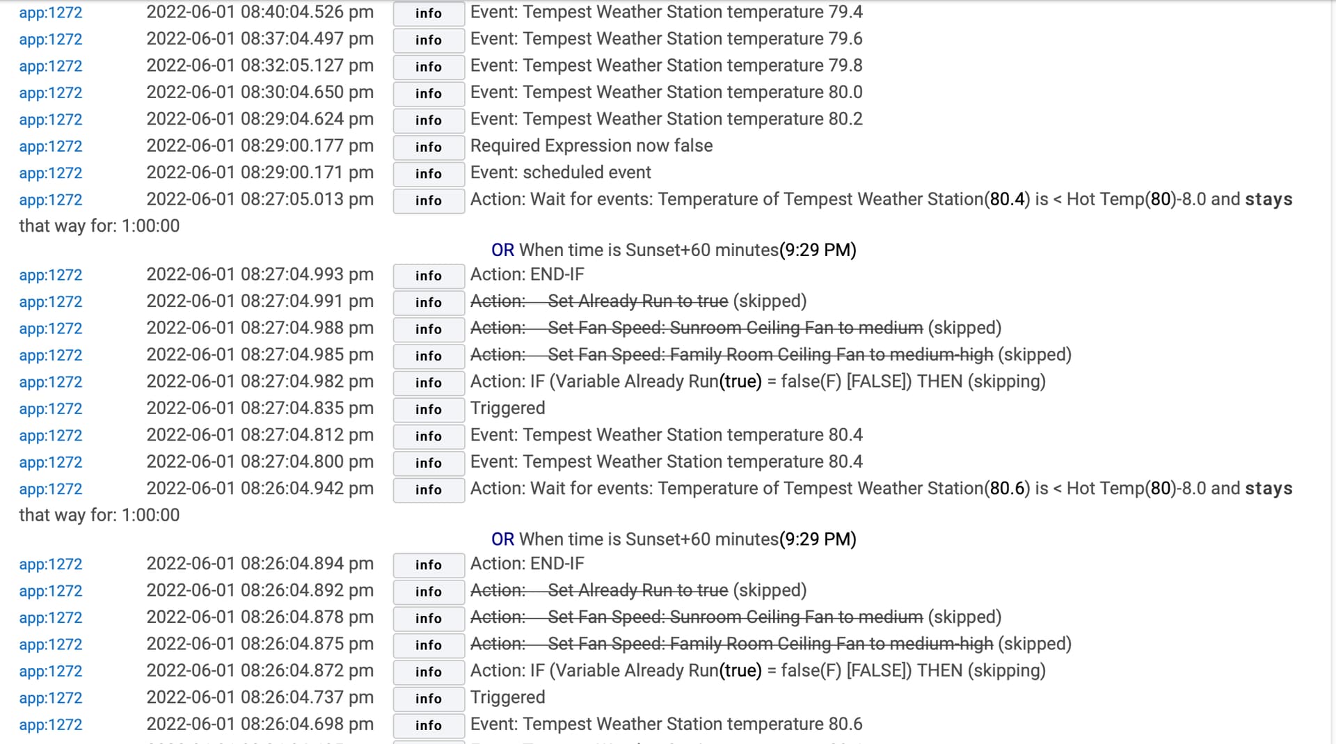

I had logging enabled. Here are the logs from sunset to the time that the condition should have turned off the fans. The line that appears to be the issue is "Action: failed to stay for 1:00:00, still waiting: Tempest Weather Station temperature 76.4.
Are these the correct logs? The rule shows the action as Wait for expression but the logs show Wait for events.
Sorry. That was part of my troubleshooting to date. I originally had the rule setup with the wait for events as either being 1 hour past sunset OR the temp is below 72 degrees for an hour. That are the logs that are showing. When I ran into the issue I then tried changing it to a wait for expression that is the snapshot in the first post. I get the same result either way. The rule should work with either wait condition (I would expect).
I can see now that you pointed that out that the wait state is applying the condition of waiting for an hour to the specific time (which cant happen), but the rule shouldn't do that becasue I set up with wait for events as either the temp condition for an hour OR the specific time (without the hold for an hour). I will change to rule back to wait for events and remove the requirement that the temp be held for an hour and see if that makes a difference. I wonder if this is a bug.
Wait for events seems like the way to go and I agree that the 1-hour shouldn't be applied to the time. Let me try a simple example to see if I can reproduce. If so, likely a bug and we can get Bruce involved.

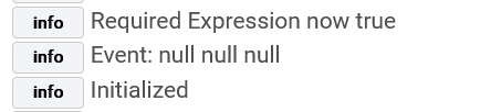

Any idea what might cause the log to show null values?
I'm not sure. What is the actual event or action?
Between two times
What's odd is the nulls are in the log but the rule works.
Same thing comes up for satisfying the Required Expression which tests NOT away, time between two times, and Priv Bool being True
EDIT: Adding Rule. Let me just say this started with the simple monitoring of "Motion - Hall" Temperature and since I have added other measuring sensors JUST TRYIN to get the dang rule to trigger. The fundamental goal was to turn on a small AC unit between two specific times IF the temp was above a threshold and to turn it off by the end of that time window or before if the temp was below a threshold.
My guess is there might just be something odd in the code that generates those log entries. @bravenel would be the one to suggest what more might be helpful to figure it out if the description above isn't enough.
You should post a screenshot of the rule. Without anything to look at, my guess would be incompletion of certain inputs within the rule.
