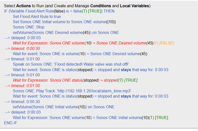

If i set a delay the action is laggy. I have to wait between actions and i don't like it.
The initial rule had timeouts instead and only 5 sec delay (stays that way for 5 sec) so if the event occured in 5 sec it wouldn't wait for 1 min.
I will test and finetune the delay to a couple of second if needed at all.
At the end i still don't like that RM does not run instruction by instruction in loop.
I am used to PLC programming.
Basically if i have a wait for event instruction at line 6 it should not by allowed to execute instruction at line 7 until the event occurs.
Actually i had to switch to wait for event again.
I've looked at the logs when triggering the rule and it actually waits for that event.
With wait for expression (the one disabled in the screenshot) it did a weird thing. It never spoke but went directly to playing the alarm tone.

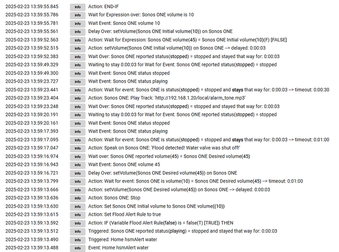

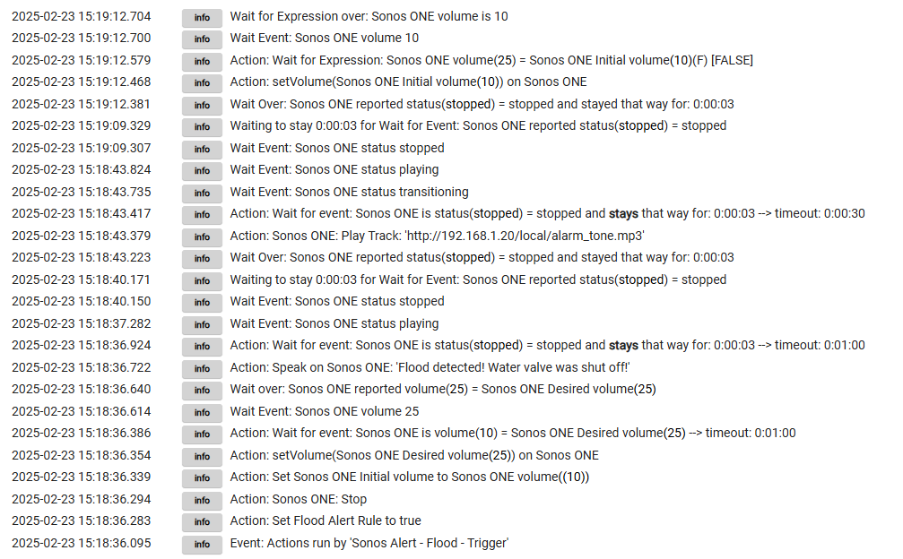

Here are the logs.
Regarding multiple instances, i've used a boolean variable to make sure that does not happen. Basically if the rule is executed the boolean Flood Alert is set to true. Only after i manually reset the hsmAlert the variable is set to false.
Maybe there is a better way to achieve this. I've tried with required expression and cancel pending actions, but once the variable is set to true the rest of the rule does not execute. So this tells me that with the current setup, the rule executes all the instructions until the booleand is set to true.
