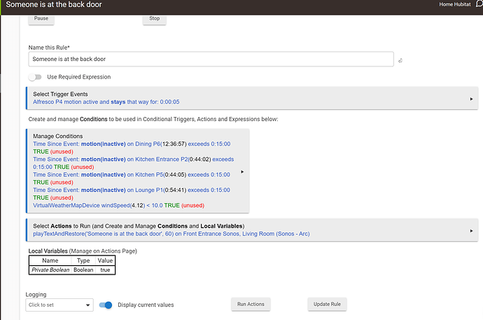

That sounds logic but not so easy in the non logic interface. When I add the motion sensor 2 and 3 inactive there is not option to choose the 15mins period (see screenshot)

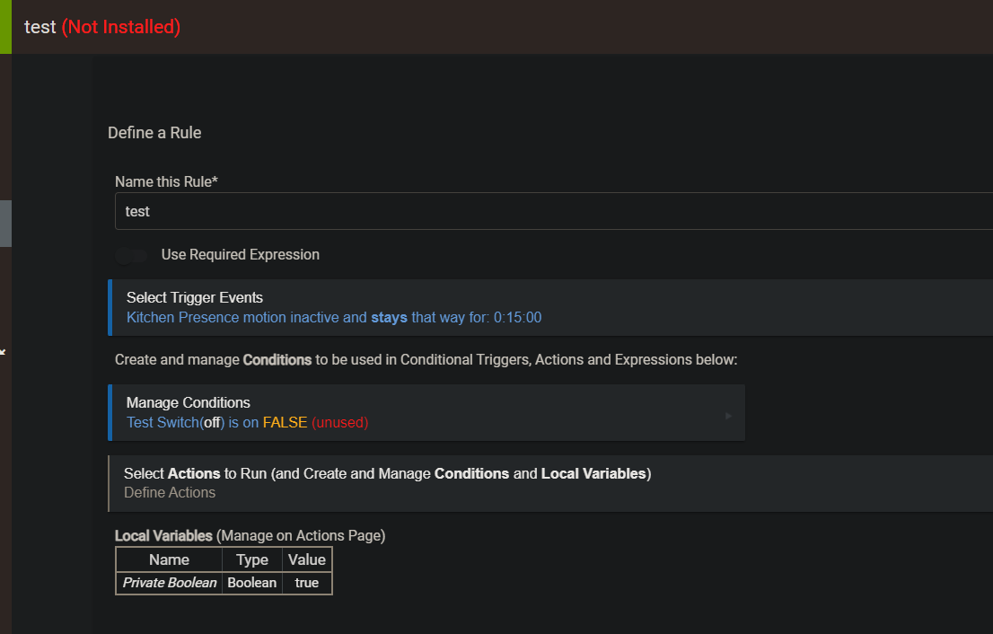

You will need to split this into two rules...
One to detect the inactivity and trigger a switch / button, and a second that checks for this.

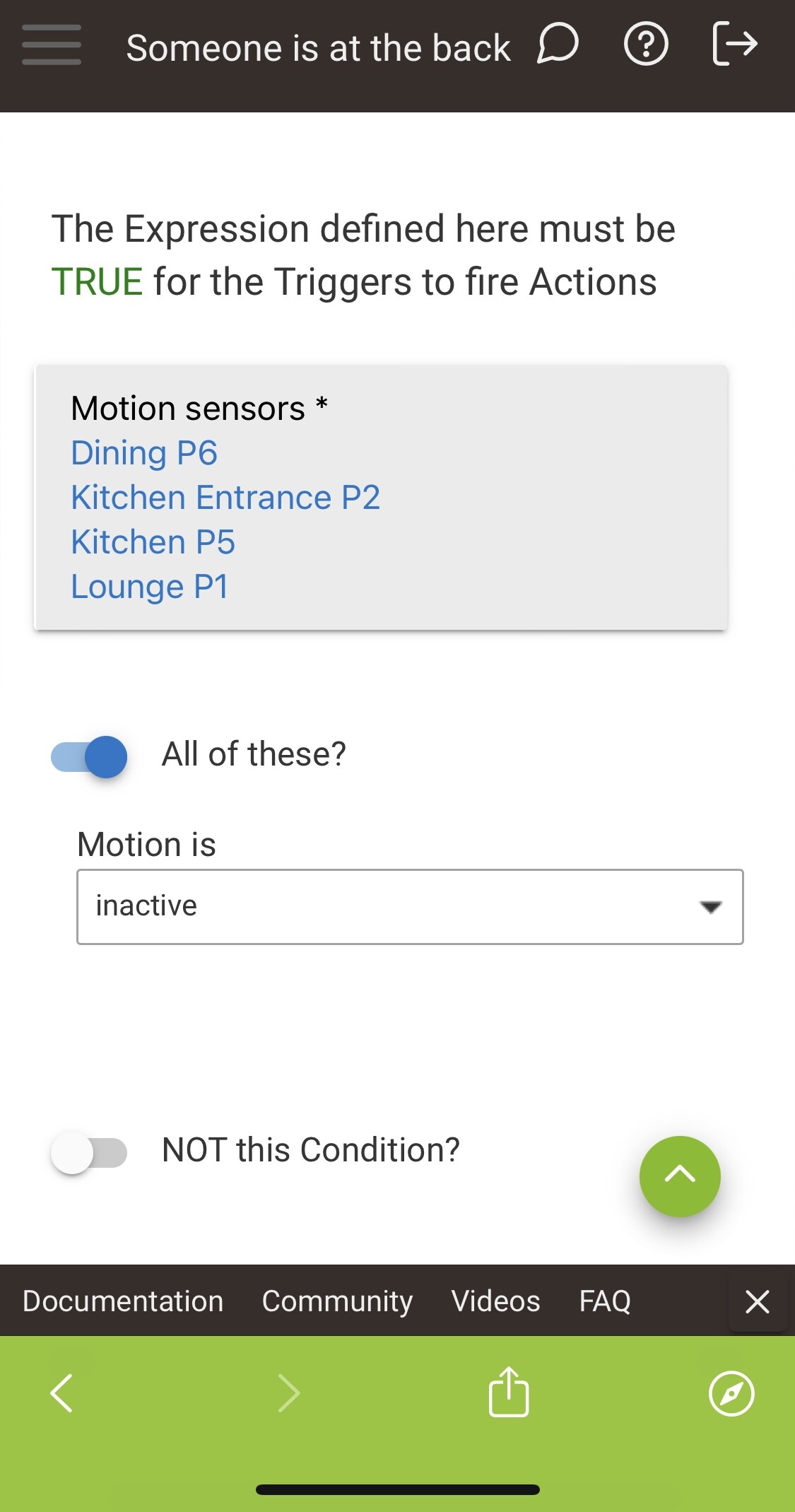

What if you select multiple sensors for the inactive period, does it let you stipulate the inactive period still?
Using that logic I should be able to create a required expression with multiple sensor and specify they should be inactive for 15 mins before the trigger can be active aged but I can not seem to do this.

Might you be able to show a screenshot with the correct statement please?

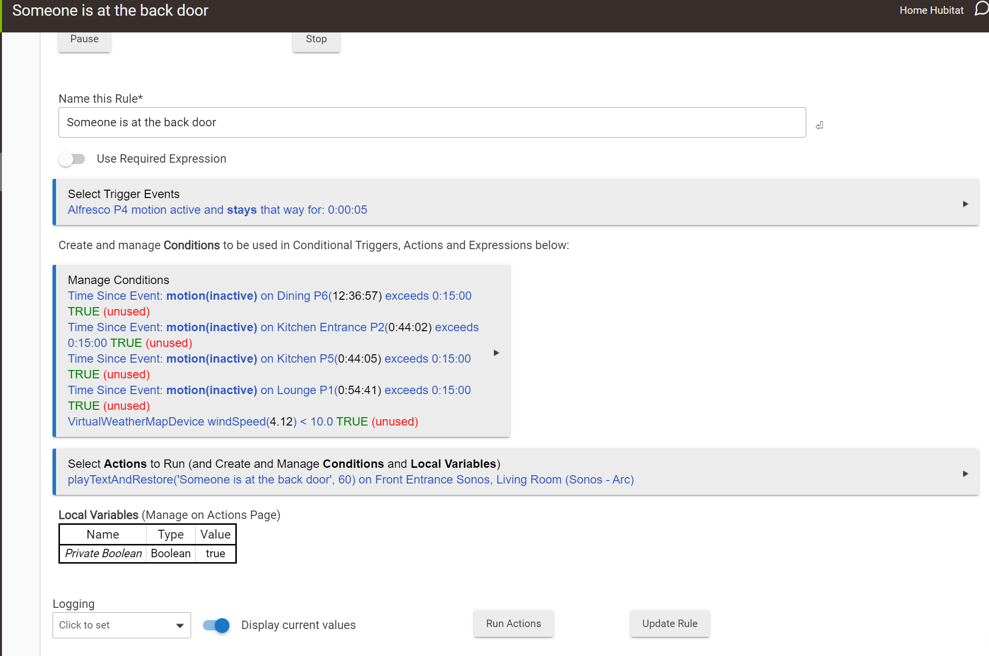

So far i have the below rule but it shows as all conditions are "unused" i assume that i have missed linking or something ?
Having conditions in the Manage Conditions section does not mean they take effect. You need to include them in a conditional action or something similar for them to be used. What are you wanting them to do within the rule? Limit when it runs?
yes, still as per original requirement
Then you will need to include a conditional action at the beginning of the Actions section that uses the conditions, which will limit when the TTS message is played.
