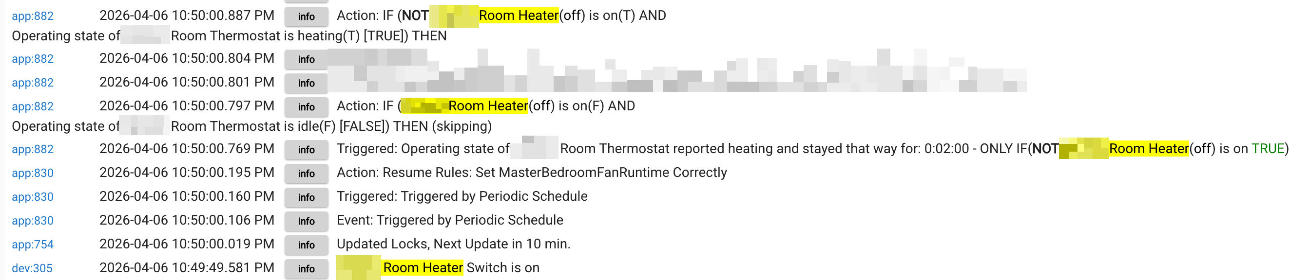

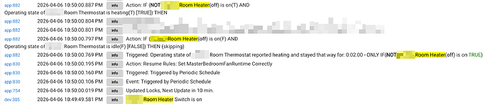

You can see in the screenshot below at the very bottom where the switch reports on but the rule, when it checks, finds it off. If I check the device page itself, it shows on, so it's not a mesh issue. The device is correct but the rule isn't seeing the correct value.
Assuming you've made sure that the device in the rule is the exact same device (e.g., not just one with a similar name; going to the App Status page -- "i" icon -- for your rule and seeing if you can find the device name in the Settings table there, then clicking it to go to its device detail page, is one way you can sort of figure this out), then I might try re-creating the rule. A clone, which I see you've tried, may not on its own, as it carries internal app (rule) data along with it and could just take along your existing problem.
I haven't seen any similar reports, so this is unusual. Is there anything about your device that could be causing oddities, like flipping between "on" and "off" states repeatedly (say, within a few milliseconds) or sending multiple, even if duplicate, events in a row? The "Events" tab on the device detail page or "Logs" would both give clues, though "Events" are all that the Rule would really see.
