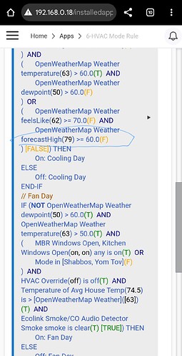

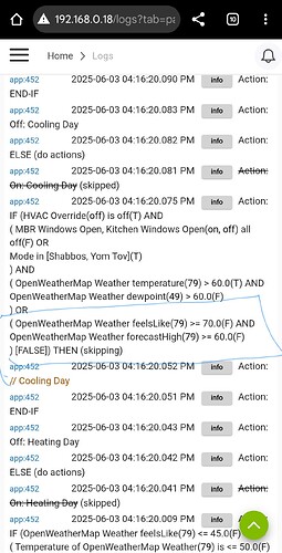

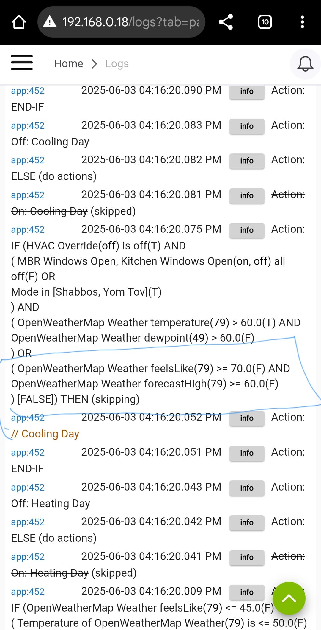

Having some trouble with a rule machine rule, as you can see in the attached images, it is showing false when the condition is actually true, the second image is actually from the log where again it shows values that should be true but is treating it as false. How do I fix this and why is it happening?

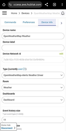

This is the device and driver. All of the values are numeric and they all seem to be up to date. When I open the conditions page on RM it changes the true or false correctly but it seems to get stuck many times and cause the rule to fail. I've been using this rule for months, it occasionally fails and when I check on it I have this exact issue every time.
OK, so that is a custom driver as I suspected above, not the built-in. A link to the code may be helpful. I'm still not sure what you mean with "variables," but I'm guessing you just mean tbe event values ("Current States" on the device detail page).

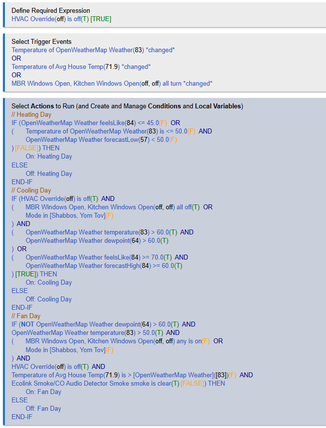

See the larger screen post attached. My issue is not with the rule itself working correctly, the issue is that the condition is clearly true yet it is showing as false - see first circled image) . (I do use this rule to manage virtual switches like cooling day and heating day, which then in turn manage their respective HVAC settings)
(This screenshot is not showing an error right now- it is intermittent where feelsLike and/or forecastHigh will show a true value yet show (F) after the statement)

When I look at your rule, under "Cooling Day" I see something that appears to be
C1 AND ( C2 OR C3 ) AND ( C4 AND C5 ) OR ( C6 AND C7 )
I wonder if you should to add an explicit subcondition, so that it ends up evaluating as
C1 AND ( C2 OR C3 ) AND ( ( C4 AND C5 ) OR ( C6 AND C7 ) )
Thanks, will do, I don't think it solves the original issue though
You are right, I was completely mistaken on the issue. I see the "79 >= 60 (F)" now.
