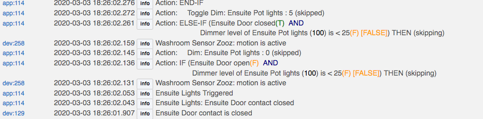

Ok, I turned on logs for the Rule and will revisit on the next misfire.

Ok, I see what is happening here. Hubitat thinks the lights in the ensuite are at 100%, when in fact they are not.
Any advice on how to solve for Lutron Devices not reporting the right levels to Hubitat?

The good news is that your comment solved it for me. I didn't realize, but 0% is not the same as OFF. Something can be at 100% and OFF. I added an OR statement and it fixed it.
