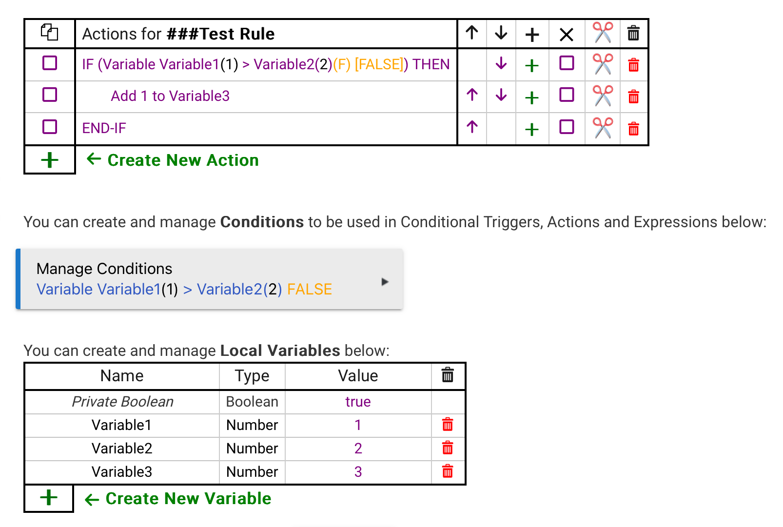

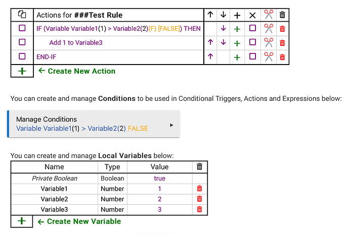

Does this help?

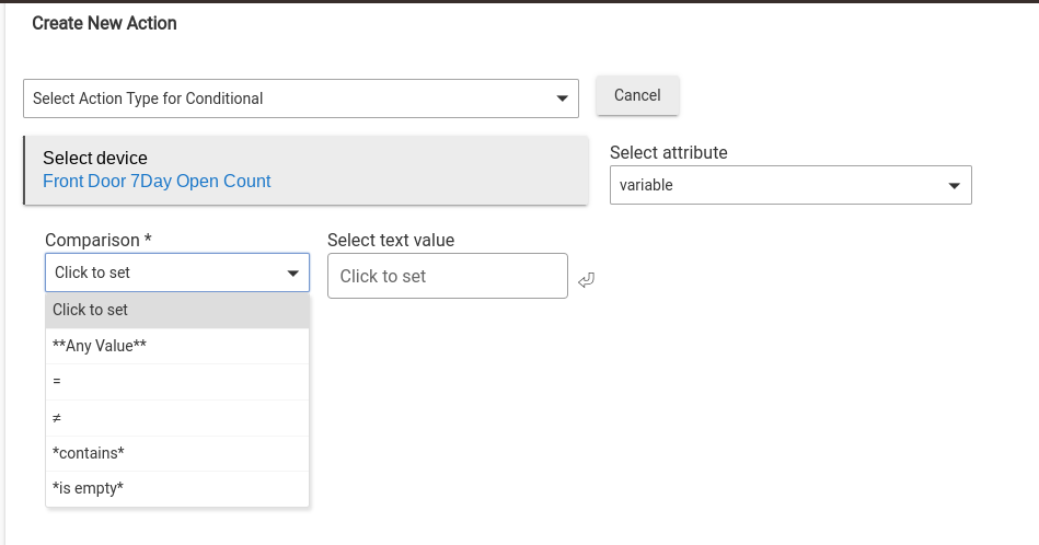

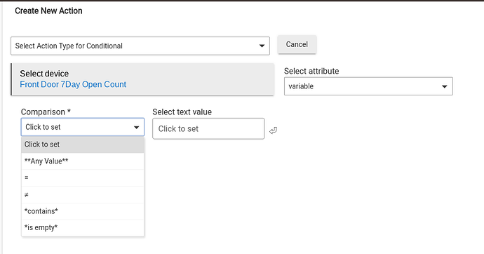

Can you show me what you use the create this action?
The reason I ask, I do not get the same choices to select the two variables

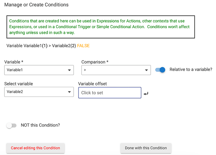

Did you use conditional Action?

Yea, this is the condition details:
OK im back, my screen does not have the same options as yours, hum?
Hum, why my options are different from your?

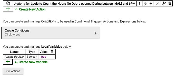

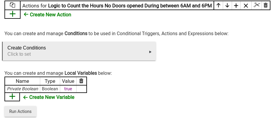

Show us your variable list at the bottom of the rule. The variables must first exist, type number, in order to have them appear as a choice when creating the condition.

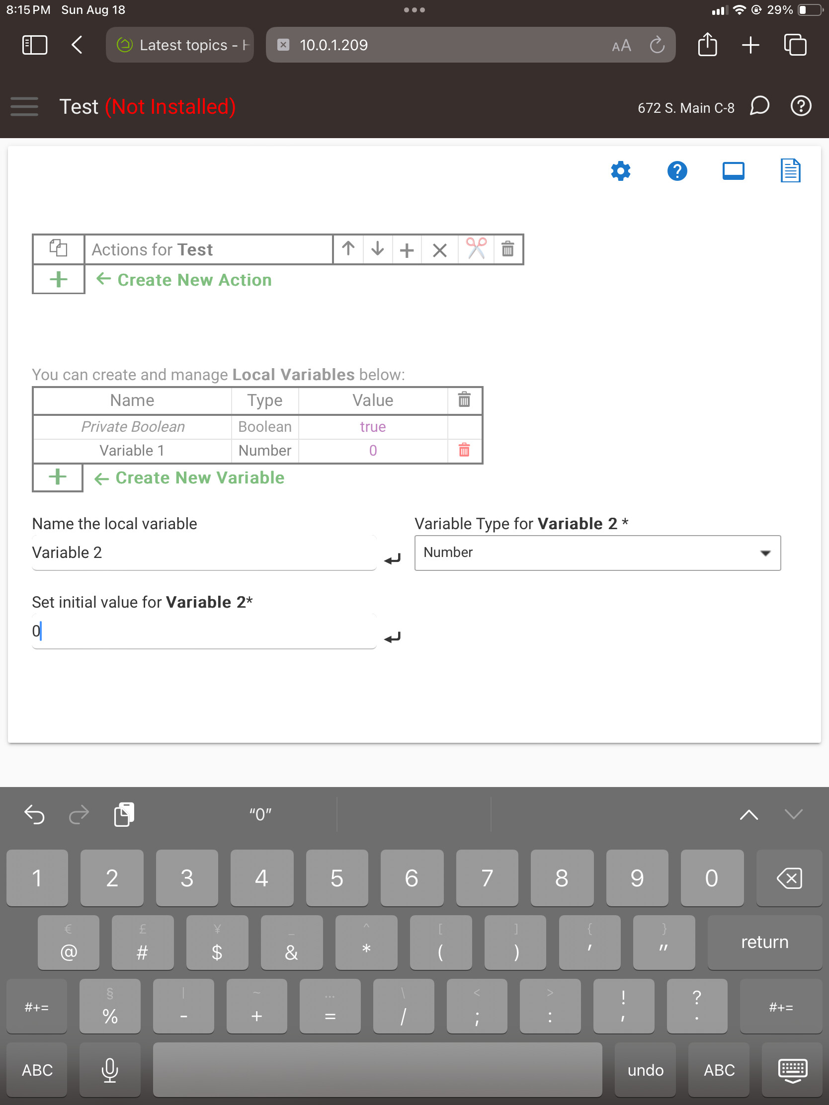

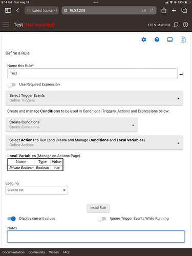

Ok, you haven't created the local variables.
Step 0: click Actions to Run (and Create ... Local Variables)
Step 1: click the + for Create new variable.
Step 2: give it a name
Step 3: give it a type Number
Step 4: give it an initial value.

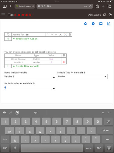

Here are screenshots after the first variable has been created, while creating the second variable.

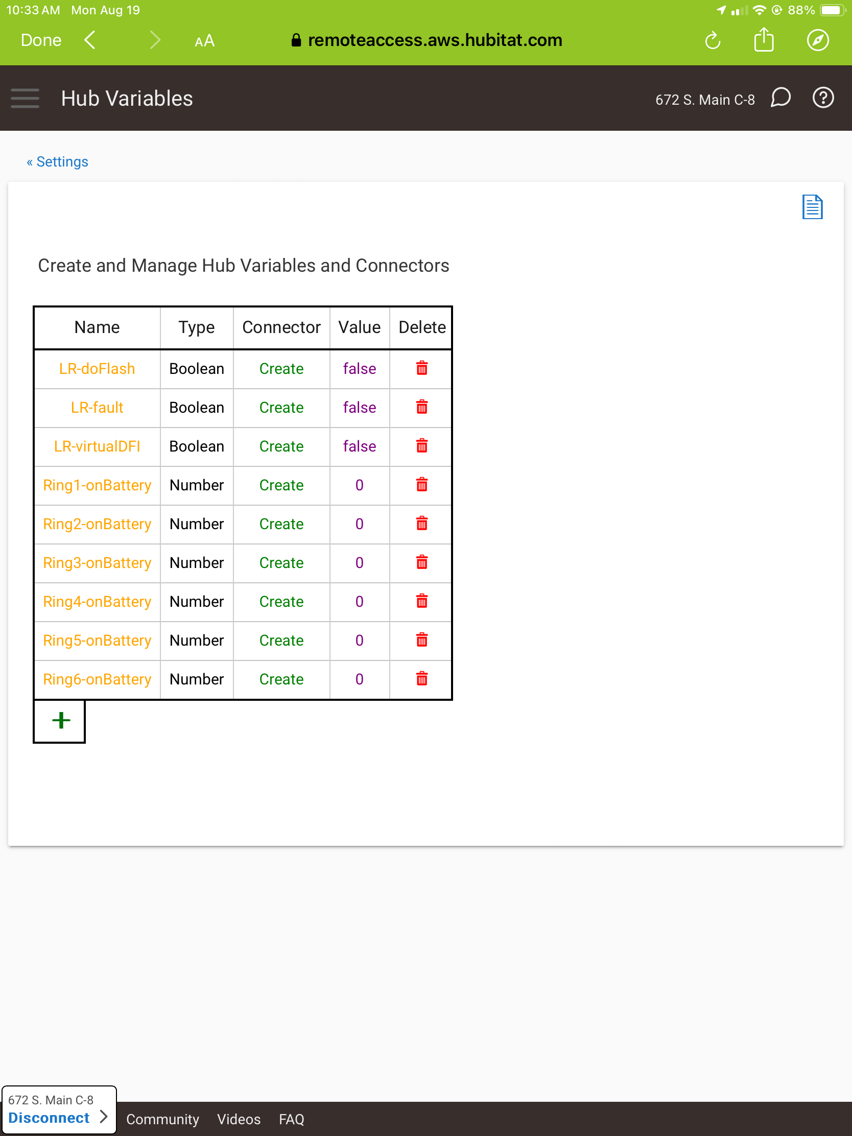

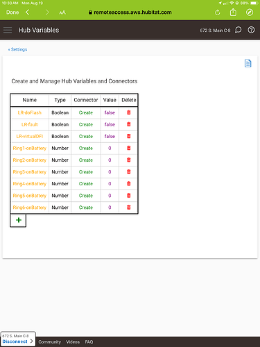

Please post a screenshot from your Settings > Hub Variables page where you created the Hub Variables so that we can see how they are defined.
Here's an example of my global variables. These variables had to be global in nature (Hub Variables) because they are used across multiple rules.
