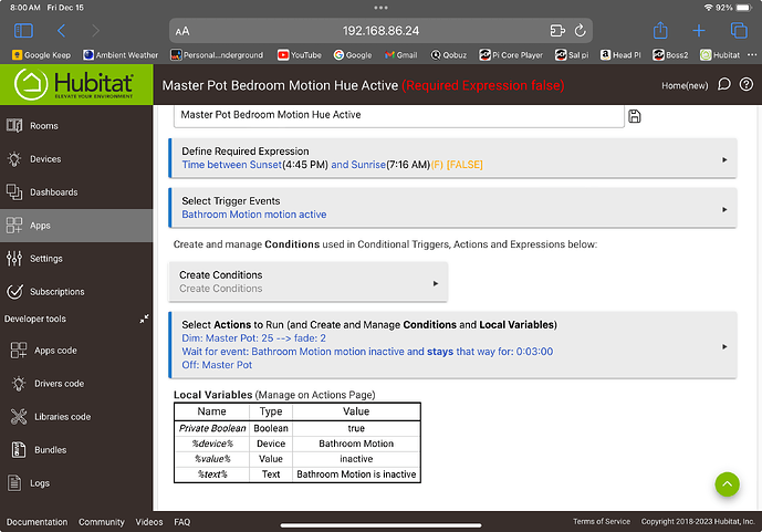

Not using HomeKit for any rules only using hubitat, I have restrictions of some of the rules. Here’s an example of a simple rule it should not turn the lights off after the restricted time. Should it. So sometimes it works fine and others it will shut the light off even when the restriction says it shouldn’t it. I may have something incorrect here,. Not sure
The light will still turn off, if the trigger turned the light on before the required expression was True, and the sensor went inactive after the required expression was False, because your rule says to wait for the motion sensor to become inactive, which it will regardless of the restriction. Your required expression cannot stop the motion sensor from changing to an inactive state.
I'd use a conditional action here and include the required expression range with a cancel and exit rule, else wait for event. But others can probably offer a better way to do it.

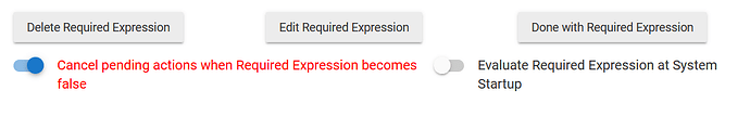

You could also turn on this Required Expression option
Your rule will only trigger between Sunset and Sunrise but will cancel your Wait and keep the light on if it become later than Sunrise
