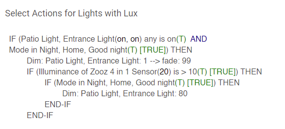

Hi, i am trying something.... i just bought a zooz 4 in 1 sensor.
I want the patio and entrance lights to be at 80% when the lux sensor is above 10 (kitchen lights on) and dim to 1% if the lux sensor is below 8 (kitchen lights off)
Patio and entrance lights go on at sunset, and go off at sunrise....
and i need this rule to work when we are home... when we are away we would like to be at 80% no matter if the kitchen lights are off...

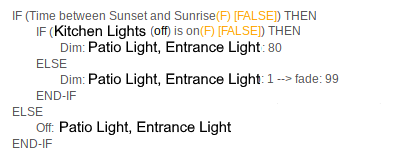

Lots of ways to do this. I would:
Triggers:
Sunset (time), sunrise (time) and Kitchen lights (change)
Rule:
Unfortunately the above rule does not use your brand new zooz sensor :slight_smile:
EDIT: Sorry, I forgot to add the condition of the correct modes to the first condition - you can just add AND Mode is...

nice thanks! ill take a look on more on the rule machine usage. i have no idea how the else will work
