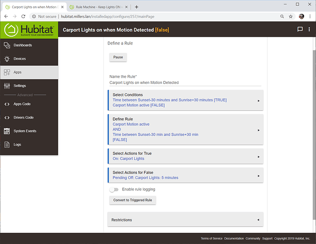

Here's what I use for my carport lights:
Under False:

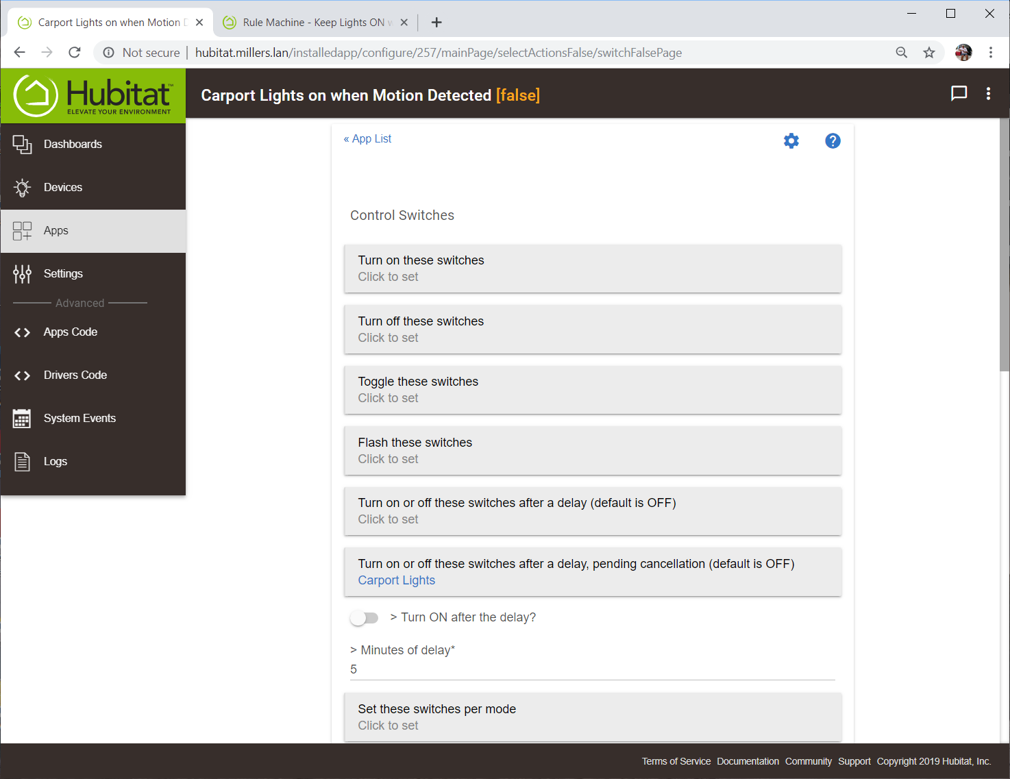

Here is the detail on the pending off:
The idea is, if there is motion during the 5 minutes the rule is waiting after the initial motion stops, the 5 minute counter will restart. This continues to happen until there has been no motion for a full five minutes after the last motion has stopped. As noted in the messages above, this may be more than 5 minutes as the sensor may take some time to switch to inactive.

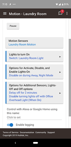

Yep! Something like this.

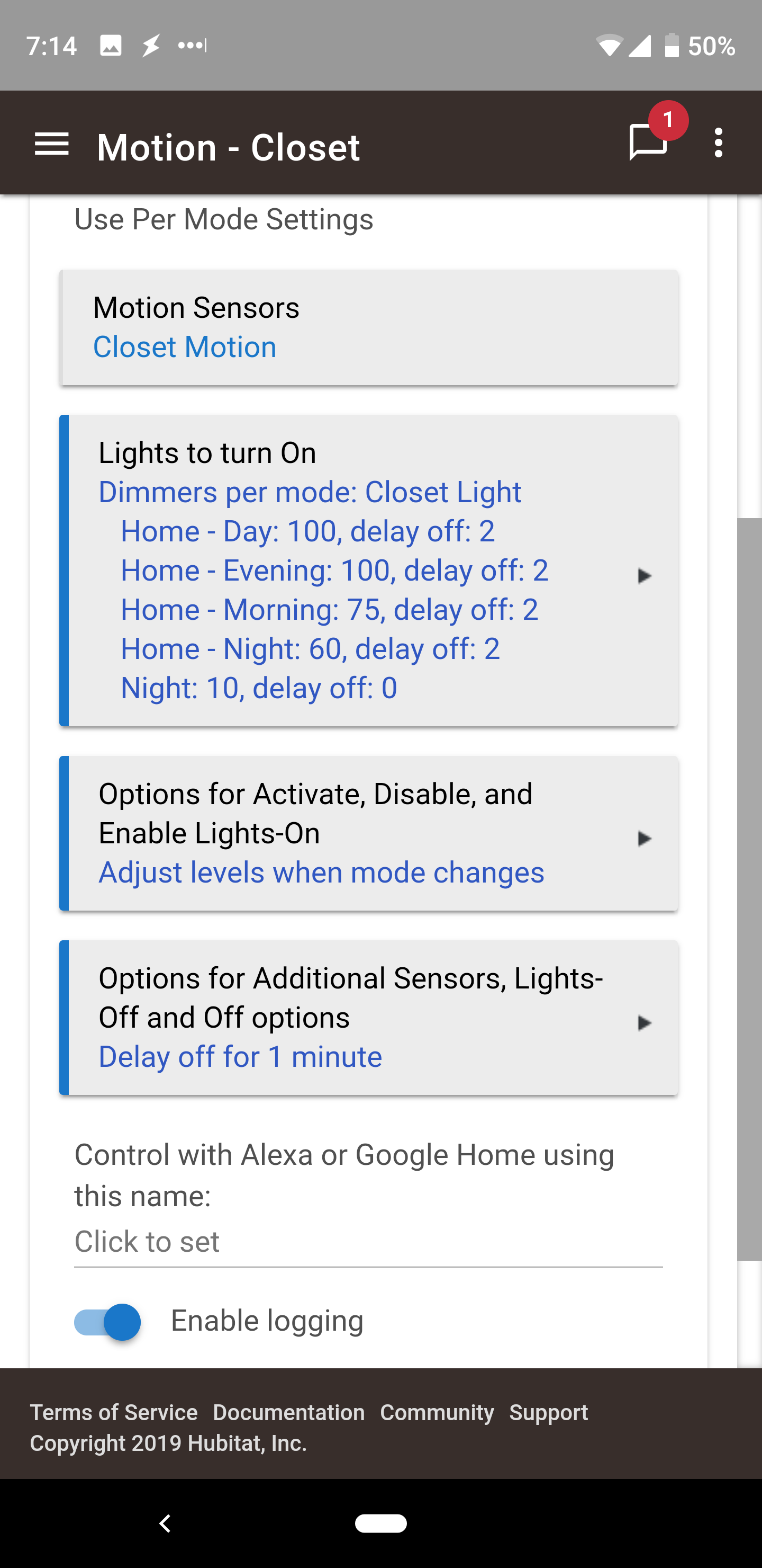

@jtodd313 here's the option in Motion Lighting that should do what you're looking for...
There's also the ability to set separate dimmer levels and delays by mode. Ignore the last delay off of 1 minute, that's a UI bug.

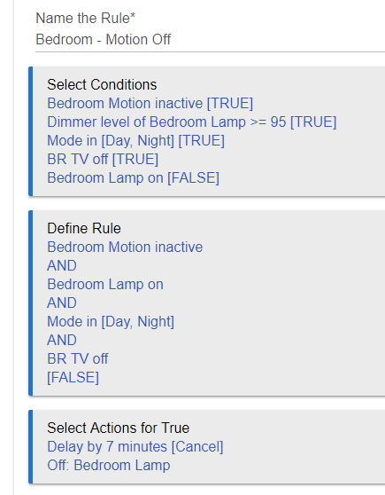

Here's an example from my bedroom motion off.
You have a pending off. You need to delay the delay (top of the actions selection) and toggle "Cancel on truth change"
