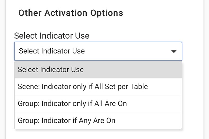

Sorry had to work and take care of other priorities the last few days. I did have a chance to play with room lighting today. I got the he initial behavior, but can’t get the virtual switch to show on when the three individual lights are selected on, and to extinguish if it was illuminated and one of the individual lights are turned off
What do you have selected under Means to Activate Lights > Activate Lights Options for Select Indicator Use? You should bwbablentonfons some combination of options that does what you want, this probably being where you want to start.
I got it figured out, I was still trying to use my virtual switch but got rid of that and used room activator and everything works fine.
The only annoyance is that if I control the lights individually, it takes a count of 5 for the room activator to recognize it should change, but really shouldn’t be controlling individually much if I want all on or off.
