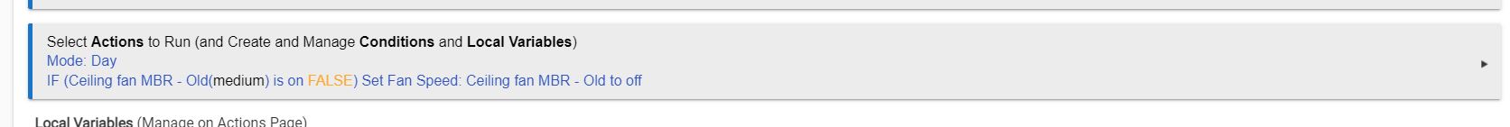

The fan is running now and shows running on the Dashboard:

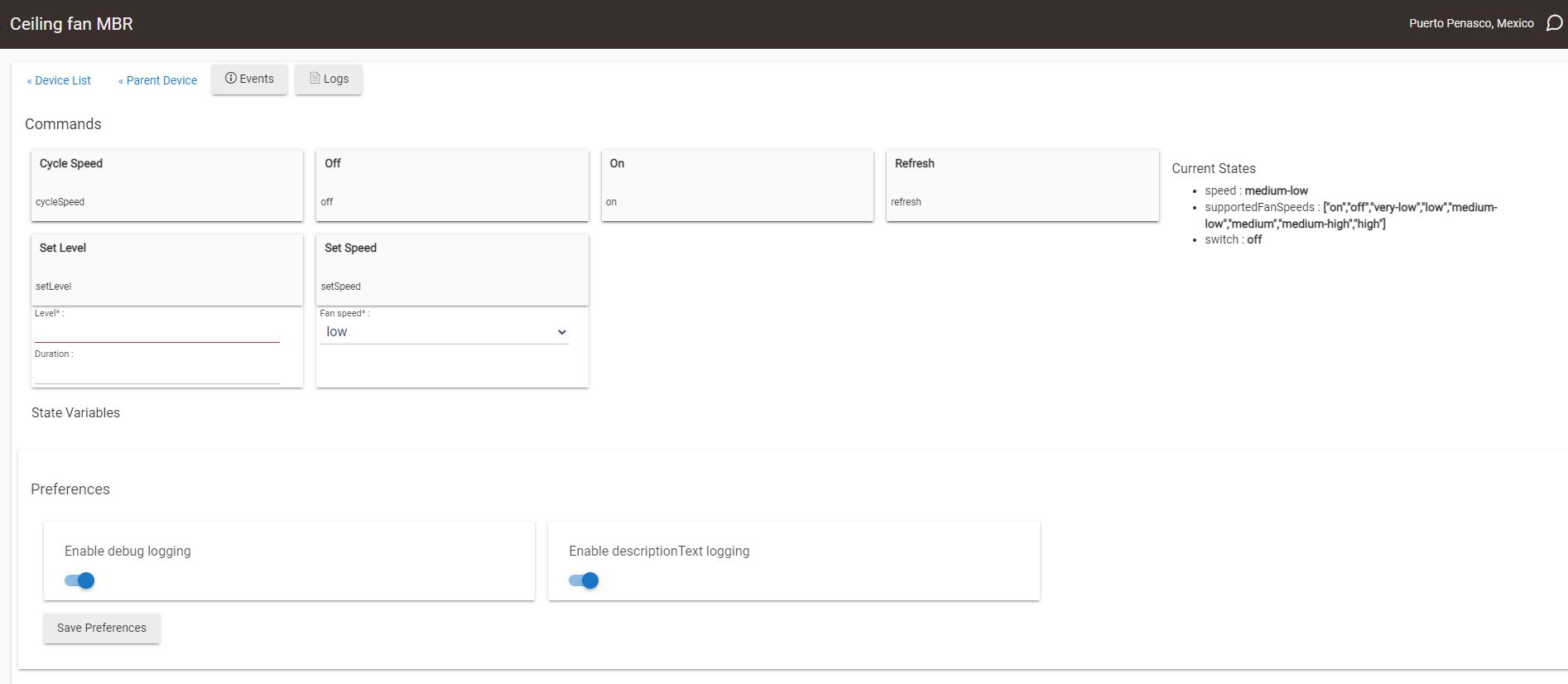

Device page also shows running at medium speed.
If I change the rule to test for MEDIUM instead of ON it will then show TRUE.

Okay I changed the rule to use the built in driver and here the driver shows the speed but switch OFF since on this driver the switch is for the light. So not sure how to test for on/off of the fan itself.

Look at the speed attribute when on or off; I'm guessing you'll see either a specific speed (e.g., "medium") or "off" as the value. I seem to remember seeing "on" as an option here in some drivers, maybe just virtual, and was thinking of that above, but I'm not sure that really makes sense unless it's an on/off-only device.
Using the "Fan Speed" capability/condition type in RM plus NOT "off" should work to test for anything that is on. Looks like you may have figured that out above while I was typing.

That's because the speed attribute for this device is probably always either "off" or a specific speed, but never just "on," which would mean just that specific value (I assume "on" would really only happen for just one-speed fans? I have never used any on Hubitat...).
But yeah, I agree that the "switch" attribute as an simple test for on or off certainly makes this a lot easier, but the trend seems to be to reserve that for outlets or lights with newer drivers (maybe to make things less confusing for voice assistants?). The built-in Bond driver is one that follows this path. The community driver may have done it another way.
