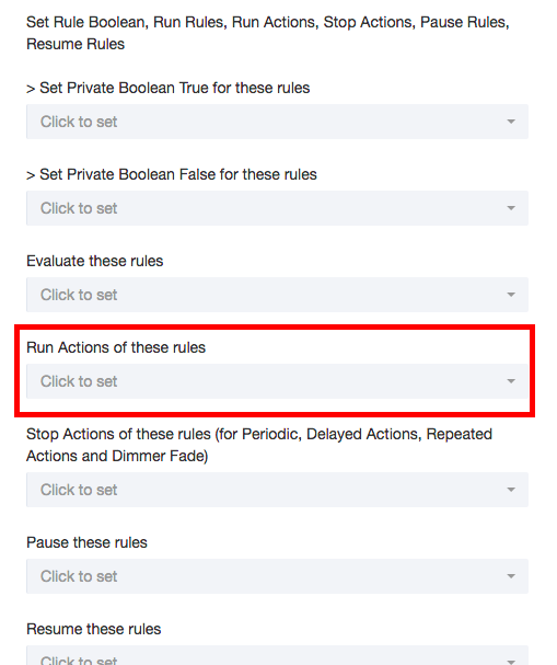

Would it be possible to code a change, to select multiple audio players. Currently it's only possible to select one audio player. I want to be able to select all 7.
You could create a rule of each of your six other audio players and then from the main rule, select "Run Actions of these rules". You can select from as many rules as you have with that. When the main rule becomes false, use the field below to Stop Actions of the six other rules, thus stopping all your music players at once.
Thanks. All I want to do is set the volume of all my audio speakers to 20% every morning at 2am. I used to do this on webcore, but I had to remove webcore. Send weird to have to write 7 rules.....
They don't have to be full blown rules. The other 6 could be triggered rules. In fact (although it limits their flexibility a bit), the other 6 could have their tigger be the rule truth of the main rule. Then you would actually only need to stop action of those rules, not start them too. They would start when the main rule became true.
webCoRE is a complex rule engine. Rule Machine is more like a bucket of building blocks. You can make just about anything you want, but you have to put the blocks together.
This should be easy to add. Will look into it.
Super easy --> in next release...
