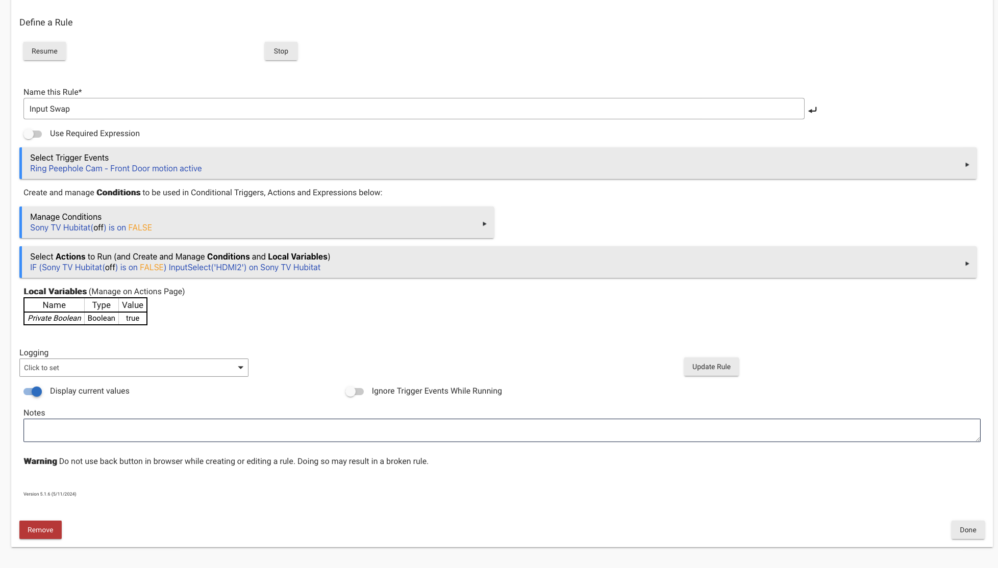

Assuming it is the same Sony Rest driver that I use, you just need to select a simple conditional action. Have your TV being on as the first part, and then selecting a custom action.
Trigger
Motion on Ring Doorbell
Action
If Sony TV Switch is on, Run Custom Action - Switch - Sony TV - InputSelect - String - HDMI2
The rule:
The custom action:

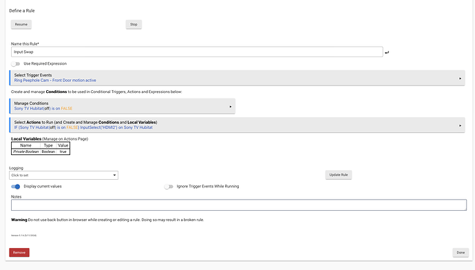

I think I'm close @JB10 but my condition is flagged as UNUSED? Would that go away once I got the IF part figured out?

Also dont I want the condition to be Sony TV(off) is on TRUE?
I only want the custom action to run if I am actively watching TV.
BTW - What is the (off) in parenthesis? Is that just showing the current state of the device?
That sounds correct. But although you've created a condition, you haven't actually used it anywhere in the rule yet -- that's why it says "unused".
That condition could be used as a conditional trigger or in a conditional If-Then action statement.
ETA -- the reason for that condition "corral" is that some folks like to create their condirtions ahead of time as part of their rule-building process -- then once you get in the the action-related steps, you just use the conditions you already built. Alternatively, you can build conditions as you go -- either way, they end up in that corral.
And that's useful because if you later edit the rule, you just need to modify the condition(s) from w/in the corral -- you don't have to dig into the guts of the rule itself to modify them. In longer/complex rules or in rules where the same condition is used in multiple places, that can be a godsend.
Correct - that shows the current state. And that's why your condition shows False at the moment -- the condition isn't currently true.
So I think I got it.
