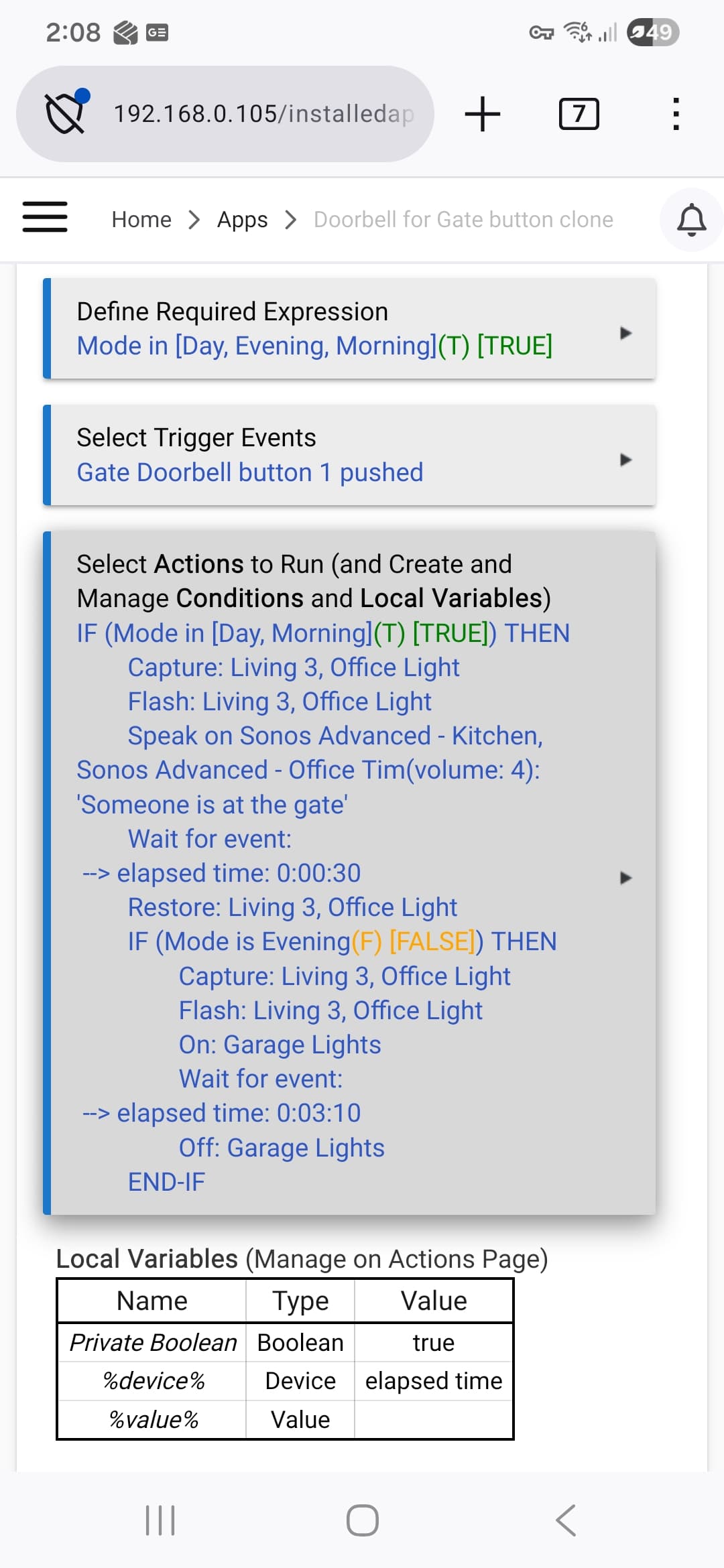

I have a Rule Machine Rule that uses Flash Switches action when my doorbell is pushed. The switches that flash are a few lights in different parts or the house.
What do I need to add to stop the flashing after a certain amount of time?
The Rule works perfectly except i have use the hue app to stop the lights flashing.
Any help most appreciated
I have only a little experience with flashing a light, but in my few encounters, I found that to stop a light from flashing, I had to insert an action to turn it ON and another action to turn it OFF. You might try inserting that 2-action sequence for the flashing light right after either or both of your WAIT actions.
Also, the first IF action lacks a matching END-IF action; it appears that the matching END-IF should go right after your existing END-IF (which pairs with the "IF (Mode is Evening) THEN" action).

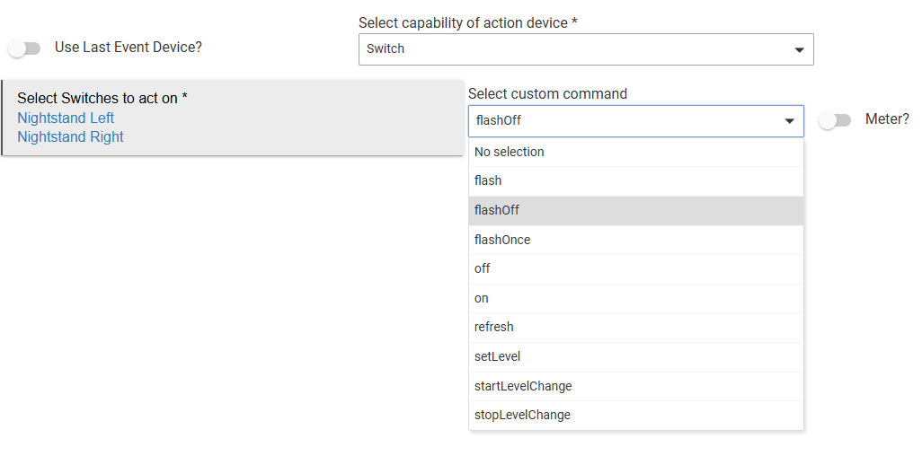

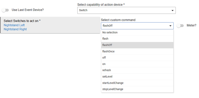

I ran into a similar issue. I use the "flashOff" from the custom commands.

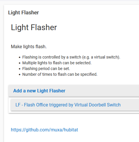

Someone already has built us a tool -
Thank you CAZ!!!! I would never have found that command without you.
