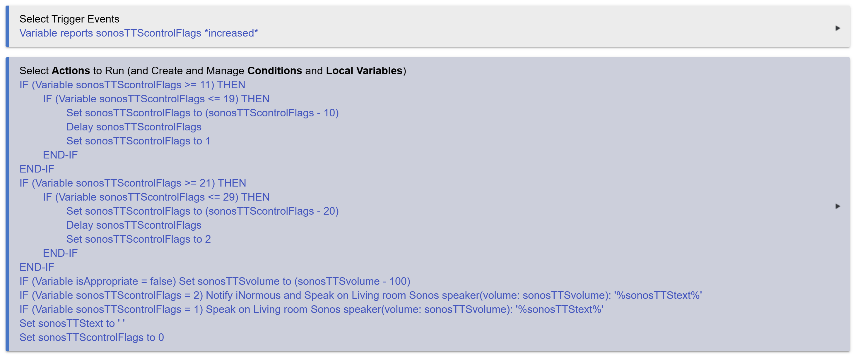

Is there a way to fix this behavior: I added a condition to an ever-more complex "Speak" "function/rule". The new condition is 'isAppropriate' which controls tons of other behaviors too according to varying conditions (time of day, volume of things, etc.) This "function" makes it simpler for me to control what verbal/notify behaviors other rules trigger and when they're allowed (and at what volume). As soon I added it, I got an error and have been unable to edit the RM 'Actions' since. Cloning it didn't help, nor did Export/Import. Here's the rule:

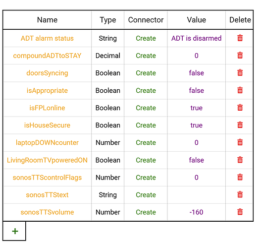

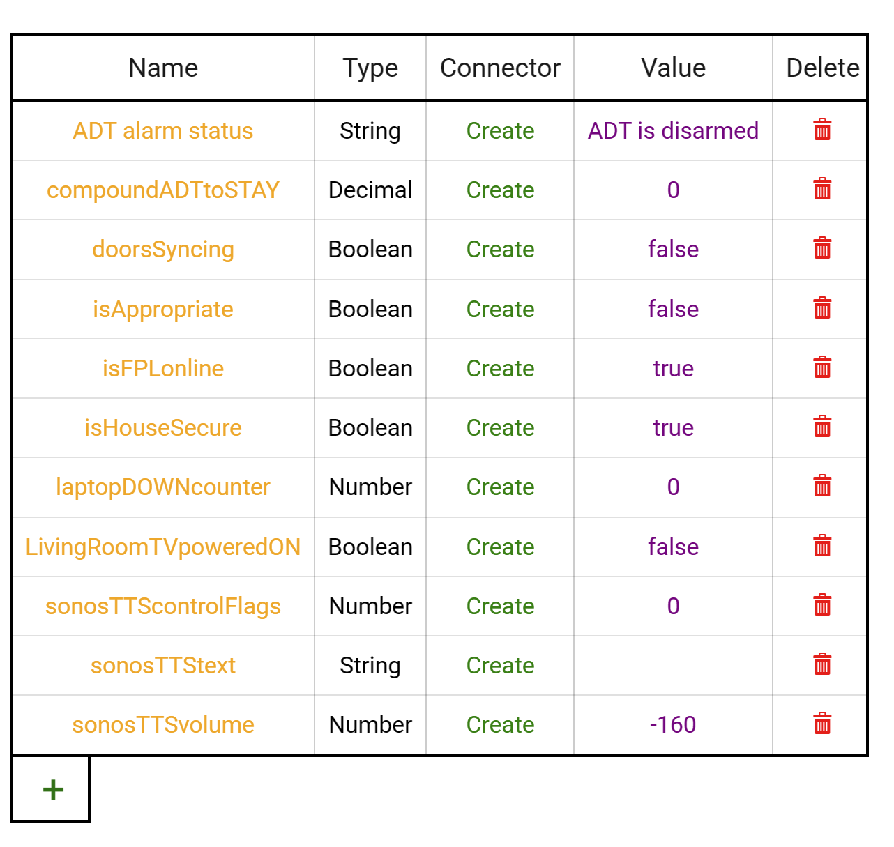

Here are the variables and their respective types (I've no idea why there's a type mismatch all of a sudden):

The next step (assuming this error never occurred) was to add one final condition based on 'isAppropriate' to restore the volume to a usable value. I've manually overridden all the variables' values to ensure that isn't the root cause--didn't help.
Ideally, I'd like to export, edit/fix, re-import this rule because it took ages to create with the UX. :slight_smile:

// EDIT: how do I resolve object '22' to a human readable form? I'm asking because, if I delete whatever that is, does that not eliminate the type mismatch error?
^ tried that--didn't work. Deleted every related variable, didn't work. So how do we have a type mismatch between two variables that no longer exist.

None of the variable types were changed (not even sure that's possible given my limited knowledge of the platform) so the type mismatch didn't stem from that. The rule grew over time as I added conditions and worked well (after tweaks :slight_smile: ) at each iteration.
To your question and as best I can recollect (confidence high): the last 3 changes I made were these prior to the rule breaking:
I can't fathom what string would end up with a value of '22'--that's the controlFlags variable but that's always been of type 'number'. The only string involved here is the sonosTTStext string which isn't part of the equation (literally and figuratively). All variables were global prior to my mod below.
