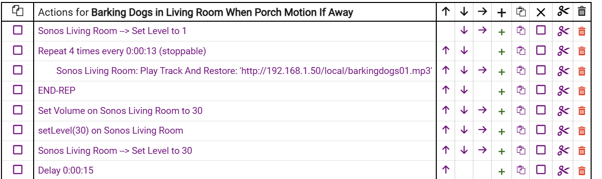

I have an app in Rule Machine where I use a couple of different expressions to do the same thing, but I don't remember why. Both are to set the volume in one of my Sonos players. The first rule (which seems to work) is "Living Room Sonos --> Set Level to 85". The other rule (which doesn't seem to work) is "Set Volume on Living Room Sonos to 30". I would like to replicate the first rule (and change the volume to 30) but there doesn't seem to be a way to copy that line and paste it where I want. You may say, well, just recreate that first rule where you want it. But the GUI doesn't seem to allow that; it only allows me to create it the format of the my second rule. Yeah, and I don't remember how I did the first one. Am I missing something in the Rule Machine options?

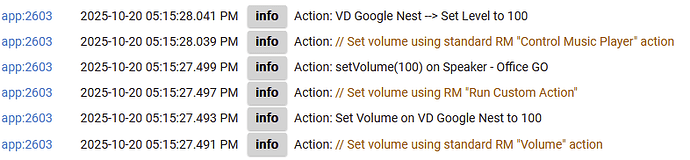

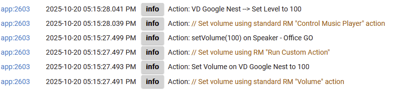

There are at least 3 ways to set volume on music or speech devices:

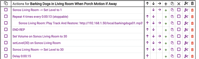

OK, well none of those options works when I invoke them to set the volume back to "normal" after my barking dogs routine runs. As stated, the first volume set action works, and I can see it work, because before I run the rule I set it higher and then it sets it back to 1 to kick off the routine, but does not set back to 30 at the end. Any thoughts? I tried all three methods as you can see.
BTW, I set it to 1 for testing so it doesn't drive my wife nuts. It also doesn't seem to matter whether I have that final Delay action before or after the reset volume actions.

Also, try putting a delay after the END-RP command to make sure the track play has really finished.Try 30 seconds to start.
If you are sure that the first volume setting action (to "1") works, I'd try to isolate the problem as follows:
  1. Disable the Repeat and END-REP actions by clicking on their associated X box at the right of the table, to simplify the test rule (BTW, it is possible the Rule never left the loop if the Sonos took longer than 13 seconds to respond to the Play Track action).
  2. Disable the "Set Volume" and "setLevel" actions the same way, leaving only the "Sonos Living Room" action enabled.
  3. Click on "Done with actions", which takes you back to the screen that includes "Update Rule"
  4. Turn on logging of Actions for the Rule in the control near the bottom left of the screen.
  5. Click on "Update Rule" and then test the Rule.

Just to be clear, your log for your Rule should look something like this (this is the log from the test Rule I posted earlier):
