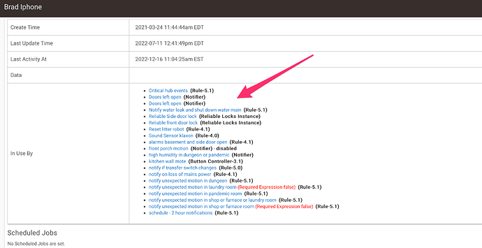

I have an iPhone but I'm pretty sure the same thing will work for an android device. If you look at your android device on the devices page and look at the "in use by" that will give you a start.
You can also look at the "events" tab on the device and see what triggered the notification.
