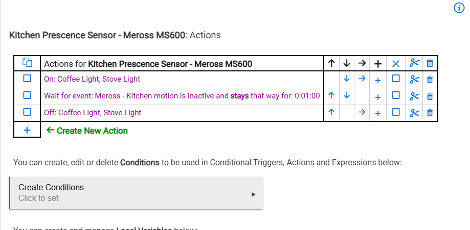

This rule is working perfect ALL the time. I would like to limit it only to 11:00 am to 1:00 pm with 3 lights. So just to clear the only change is to limit the time of day that it fires. With 3 lights.

But to answer the question: you'll see in the docs (and many examples here) that there are many ways you could do this, including a conditional that wraps your entire set of actions (or at least the ones you care about, maybe just the "On" if you always want it to turn off regardless of time) or a conditional trigger. However, the easiest option would probably be to to enable "Use required expression" and add an expression of "Time between 11 AM and 1 PM." This restricts triggering of your rule when the expression is false, which will be any time outside this range.
