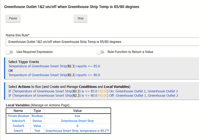

Seems something is wrong, just not quite sure what. I have the following rule machine issue. For some unknown reason, though the temperature is between the 2 levels, both conditions show False. Rule has been working fine until I updated from 2.5.0.136 yesterday. I tried creating a new rule but get the same results. Greenhouse smart strip is reporting fine.
Would appreciate if someone would check into this and let me know.
Similar rule on my C8 is working correctly, so maybe just a C7 issue?
Both hubs updated yesterday and both are running 2.5.0.157
Because both conditions are false.
82.3 is neither >= 85 nor <= 80.
82.3 is NOT above 85 or below 80. (which is how your rule is written

I think you have your trigger events reversed.
You want the temp >=80 and <=85, which 82.3 is.
I think he has the rule correct. It’s just that the data point 82.3 shows the rule is working rather than not working.
Were it me, I’d simplify the trigger to say simply if the temperature changes and leave it to the conditionals in the action as is.
I looked at it thinking the temp needs to be between 80 and 85.
I agree with your assessment.
So basically what I want is for the switches to turn on when >=85, but turn off when <=80. think I have my rule wrong somehow. Maybe just >85 on and <=85 off would work better.
Correct, but if the C7 follows the rule path…>=85 comes first. Then <=80. I don’t want it to be between 80 and 85. I want it to come on >=85, then off once <=80.

Was just commenting that your statement or expection that either condition should be true was flawed.
As written, when the trigger is above or equal to 85 or below or equal to 80, then when it is between the values, NEITHER statement could be true. If it is between, then it can't be above or below.
The rule is evaluating exactly and correctly the trigger conditions provided.
Just follow the suggestion I gave you. Change your trigger to when the temperature changes. Leave your actions exactly as you first posted.
@mavman30
To clarify,
Your rule, as written should work - it was just your perception that the "false" indicators were incorrect.
HOWEVER - it will retrigger everytime your temperature sensor reports above or below the thresholds you have (Most sensors report every couple of minutes), even though it already turned on or off your switch. This will result in numerous unnecessary commands being sent.

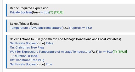

This is more or less how I would handle it.
Prevents multiple retriggers for each reporting period where the temp is still at or above 85, and eliminates the need for a trigger for when it falls below. I added a 10 minute duration to the falls below for the instance where it is hovering there. You can shorten or remove the duration.

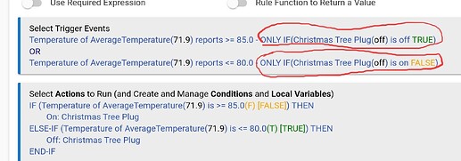

Another way uses a conditional trigger that only runs if the switch is off (for the above temperature) or On (for the below temperature).
This way, if the switch is already on, it will not trigger until:
The switch is turned off AND the temperature reported is above 85.
If the switch is already off, it will not trigger until:
The switch is turned on AND the temperature reported is below 80
This was as close as I could get…couldn’t make the “ELSE-IF”.
And for the record, in error, I was monitoring the current state of the 2 outlets that were both already on at 82.3 degrees. I was expecting the rule or a reboot to turn them off. My error. If I’d turned off the 2 outlets at that time, we likely wouldn’t be having this conversation. I do thank all for the help!!
So, if they were on at 82.3 degrees, and had not gotten down to 80 degrees, that is expected. Your trigger to turn of was Less than or Equal to 80. 82.3 is not less than or equal to 80.
Not being funny or sarcastic. More about trying to help you see....
Why would the rule turn them off if the conditions in your rule had not been met??
The rule or you had already turned them on. Now, it is waiting for the trigger to do anything else.
Is it at or over 85? - No - So rule does nothing
Is it at or under 80? No - So again, rule does nothing.

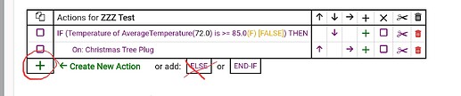

To get "Else-If", do not click the "Else" at the bottom of the table. Instead, add an action, choose conditional, and Else-If will be one of the options in the dropdown
Else-If is not an option for me.
Was an oversight on my part. Wasn’t thinking…
Got it. Thanks…so many “possibilities” depending on each selection. Gotta know the program better than I do, and have more patience to click on everything to see what options it gives. Hence why I’m here. Very clear instructions. Thank you!!
I think it only shows up after an If that isn't ended. Since your If's are already closed with EndIF's, I think it will not show.
You could delete (use the trash can to the right) on Both "End If" lines, the second "IF" line, and the "Else" line. Then you should be able to see the Else IF and add it. The condition should still be available to select in your conditions table.
