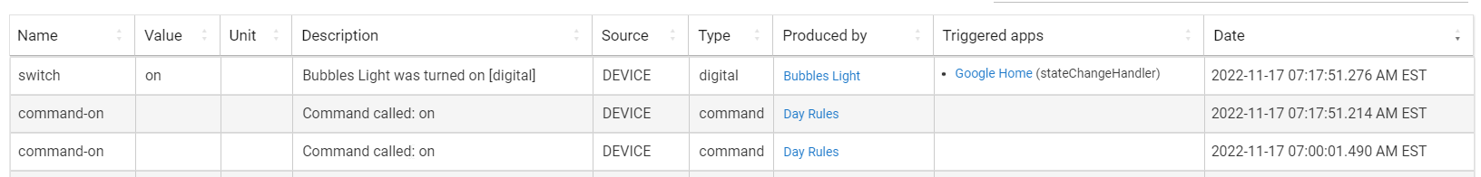

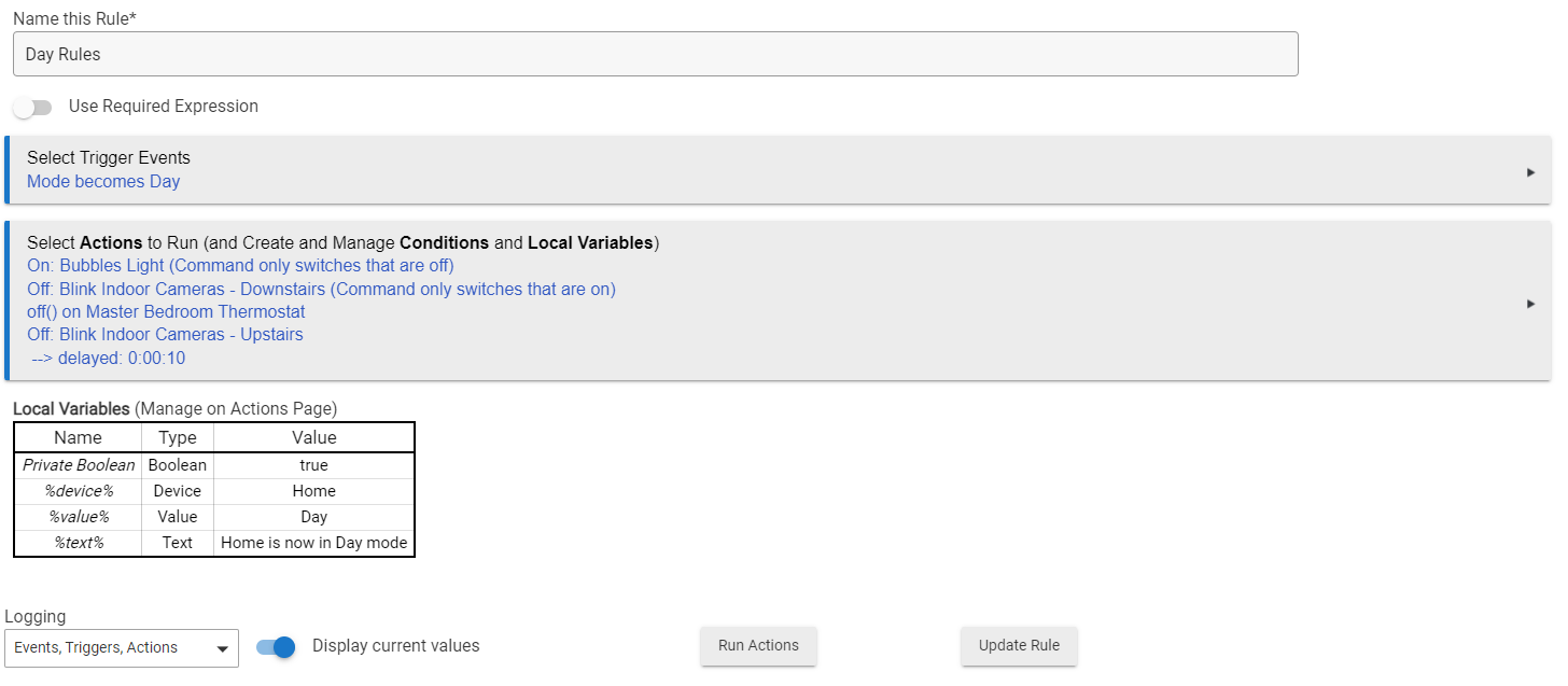

I probably should have noted that I did look at the devices themselves and I could see some things in the logs that might be telling. Right now I'm focusing on my "Day Rules" rule:
Mode Manager changes the mode to "Day" at sunrise or 7am, whichever is earlier. All of the actions are being sent, but the first one ("Bubbles Light") isn't completing. You can see it on the Device page in the "Events" where the command was sent, but it wasn't turned on:
The two events at 7:17 were me manually changing the mode to "Night" and then back to "Day" and as you can see, the command was sent and the outlet responded.

But "Events" on the device, which you did provide, is a bit more interesting in recent platform versions than it was in the past--not only does it show events (as the name suggests) but also commands that were sent to the device and what app did it. So, while we can't see all the details (again, Logs are helpful here), it does appear that your rule sent an "On" command to this device, as you'd expect based on your rule actions.
Therefore, I don't think you're dealing with a rule problem here, at least for this specific thing. If you're sending an "On" command but the device isn't turning on, you are dealing with a device or driver problem.

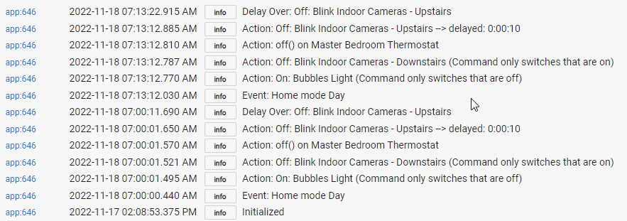

Yes, sorry. I have a hard time distinghishing between "Events" and "Logs" sometimes. It's all essentially logs to my IT brain :slight_smile: Here is the "Logs" output for the "Day Rules" rule from this morning (not really much we didn't already know from "Events":
The logs for the device itself tell a similar story (it's like the command at 7am wasn't received on either day):

Manual mode changes work fine as well. You can see in the "Logs" output above that the "Day Rule" rule was triggered twice. Once by automatic "Mode Manager" change at 7am and then I changed the mode manually at 7:13. The rule fired fine both times but the switch only came on the second time (same as yesterday - per the "Events" screenshots above).
