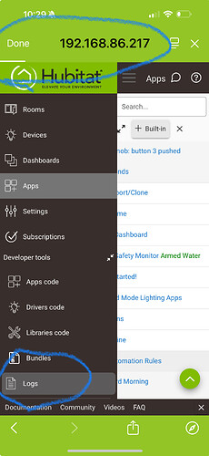

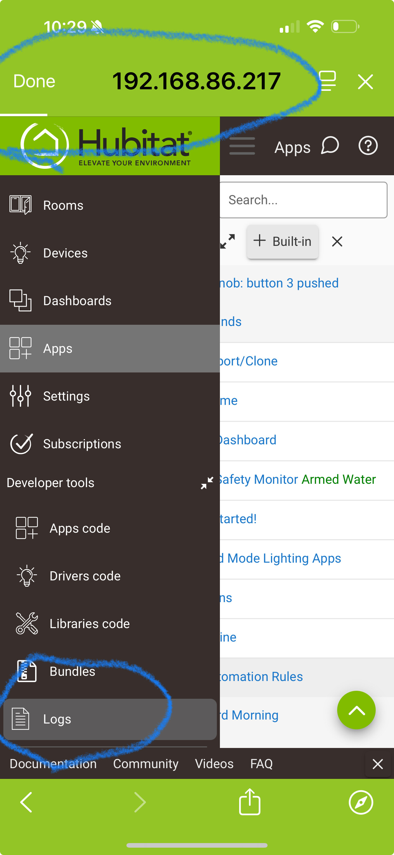

Might I suggest that you share screenshots showing the issues? That might help us find clues…
These images aren’t much help. They just show that pressing “logs” starts to load but hangs/sticks. iPhone and laptop the same.

It looks like you're using the embedded browser in the mobile app to access the admin interface. Does it work if you try this in a "real" browser? Just open the IP address in any browser, use findmyhub.hubitat.com to discover the hub's IP address if you aren't sure (or use hubitat.local if mDNS works on your network and you haven't changed the mDNS name of your hub), or -- in your case -- you could also just hit the little Safari icon in the bottom right to do the same from where you are.
It should work either way, but this would at least rule out this particular possibility. Bonus points if you can also try on a desktop/laptop or other device to rule out that's just something odd with this one.
