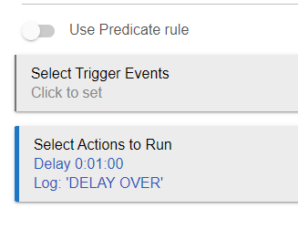

Here I just recreated the scenario with this. I did the same exact thing I described above.
I just hit run actions
Here is the logs. The second run at 7:19:37 shows in the logs the correct "delay" of 1 minute but the delay was only 10 seconds.
and then I went back in, checked use variable, the removed the variable and now it runs right.
