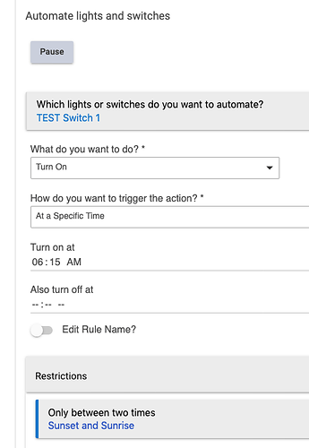

If you're using sunset and not "real" illuminance, I'm not sure you need Rule 4.0 for this. Simple Automation Rules (formerly called Simple Lighting) would probably work without a lot of effort. I'd use a few "rules," one for on:
and two others, one that turns off at sunrise (no restrictions) and another that turns off at 7:00 AM (also with no restrictions), though you can adjust everything here or combine/separate according to your preferences. (I have a restriction above so it will only turn on at 6:15 AM if it is still before sunrise.)
SAR can't handle illuminance, so you would need Rule Machine (or another app) for that. (EDIT: Guess it can and I've just never tried! See below.) But if you don't have that already, I figure no sense to make things more complicated than they need to be. :slight_smile:

Actually it does as I use it to turn on my lights based upon a Lux value from my outdoor Hue motion. Then I have a restriction to only turn on between certain times.
Nice! I didn't see this option on the hub I was looking at because I don't have an illuminance sensor on that hub, and I guess SAR tries to be smart and hide things you can't use (fancy built-in apps...). :slight_smile: That should make things easier for the OP.
