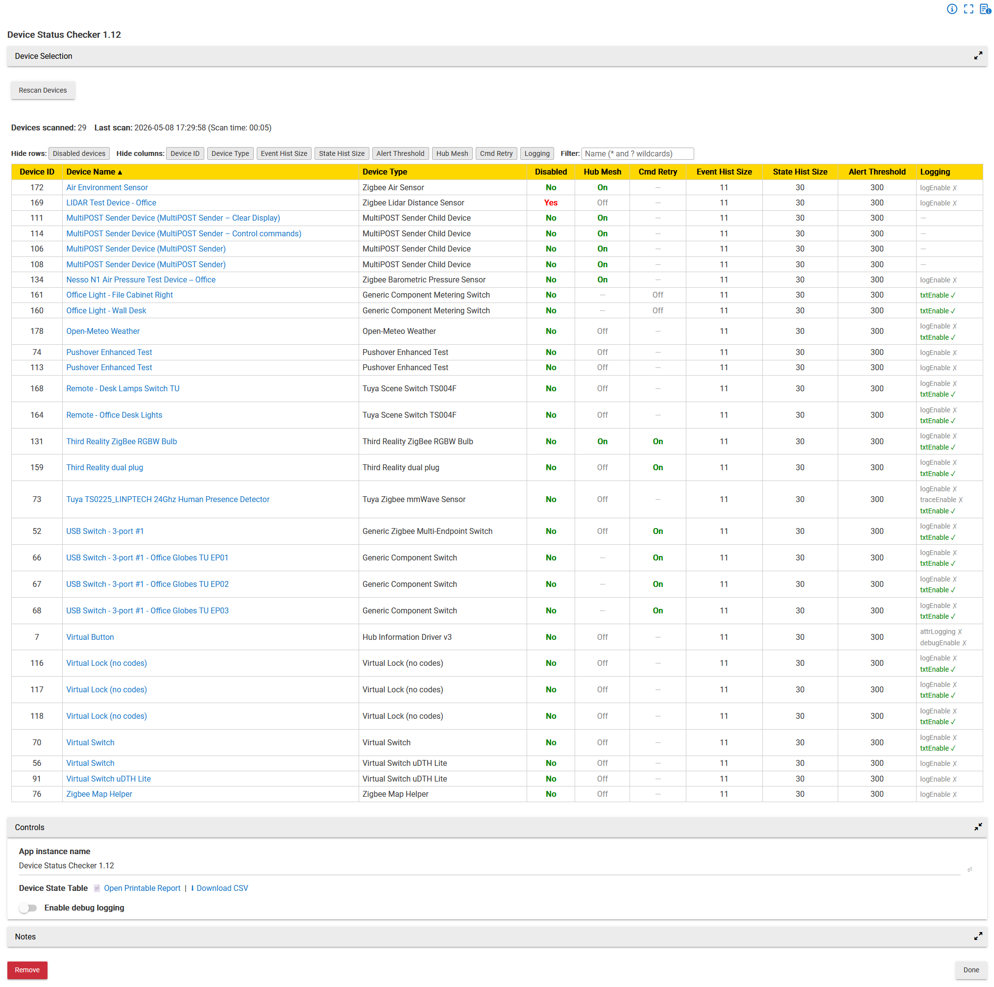

Take a look at the linked BETA app.
The app checks:
  • Device ID
  • Device name
  • Device type (driver name)
  • Disabled state
  • Hub Mesh status (On/Off)
  • Command Retry status (On/Off for devices supporting the function)
  • Event history size
  • State history size
  • Too many events alert threshold
  • Logging status
The Disabled, Hub Mesh, and Command Retry cells are clickable to change the state of a device.
The size/threshold cells are not clickable and l likely won't try to make them clickable, because it appears that to do so, the app must mess with an entire device record and not just 3 fields.
NEW: The app now checks logging status. Because the type and degree of logging is controlled by the drivers and is not uniform, a search is done for common terms used to name Boolean variables used for some type of logging. Terms that are present for a device are output to the Logging column, with logging ON being indicated in green text and a checkmark, and logging OFF being indicated in gray text and an "X". If the searched terms are not found for a device, the Logging column cell is marked with a dash "β€”".
The app may take some time to retrieve and parse large sets of devices, so be patient if you use it.
