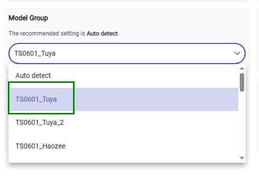

You can try using this driver, although this device fingerpint is not in the driver code yet and the correct device type will not be detected automatically.
In the Preferences tab, select 'Model Group' TS0601_Tuya and click on Save :
Enable debug logging and monitor new Zigbee messages in the live logs when you change the temperature rapidly. If the temperature still does not update correctly, re-pair the device to your hub without deleting it first.
