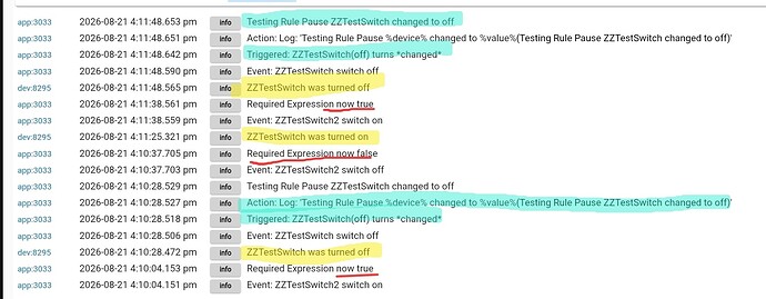

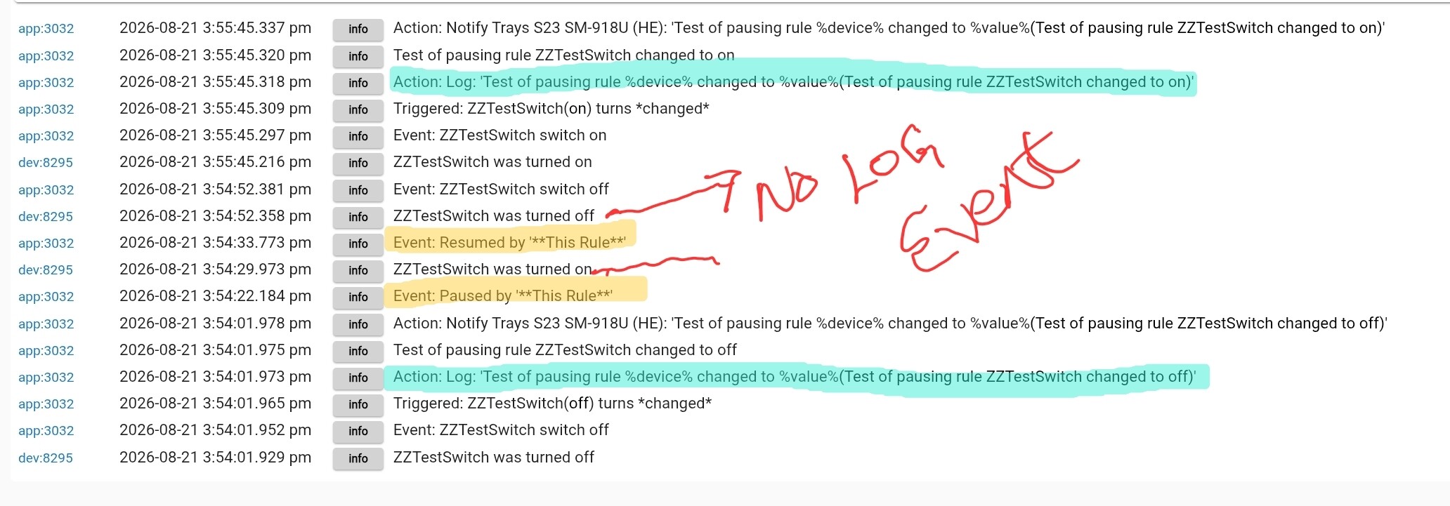

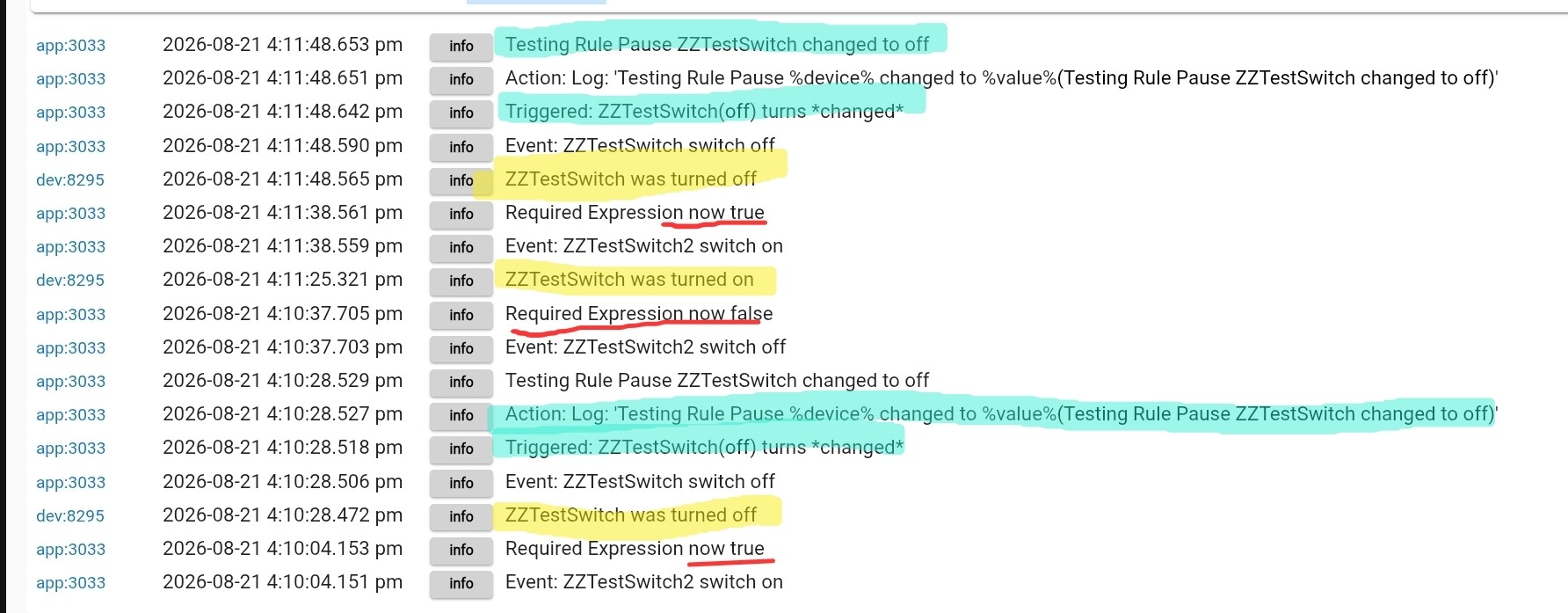

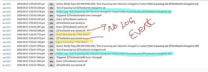

18:06:18.930  Event: Paused by '**This Rule**'          [manually triggered]
18:06:28.591  Testbutton was turned off
                [— no Triggered line at all —]
18:06:39.609  Event: Resumed by '**This Rule**'          [manually triggered]
18:06:44.525  Testbutton was turned on
18:06:44.554  Event: Testbutton switch on
                [— no Triggered line, no further action —]
18:06:53.511  Event: Paused by '**This Rule**'          [manually triggered]
18:06:59.307  Testbutton was turned off
18:07:04.954  Event: Resumed by '**This Rule**'          [manually triggered]
18:07:09.381  Testbutton was turned on
18:07:09.402  Event: Testbutton switch on

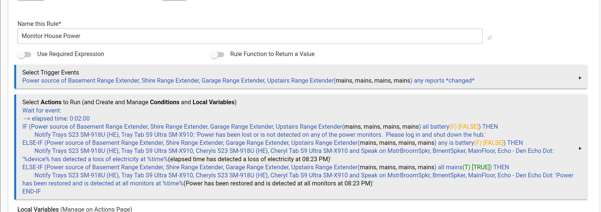

I haven't ever run into this. However, I use required expressions with virtual switches or booleans to disable rules instead of pausing them. I also use the re-evaluate required expression on startup to make sure they stay in sync.
I have paused rules that rely on changed states for testing though and didn't have that issue. But I also can't say definitively (relying on memory) that the changed states had changed while the paused rule was paused.

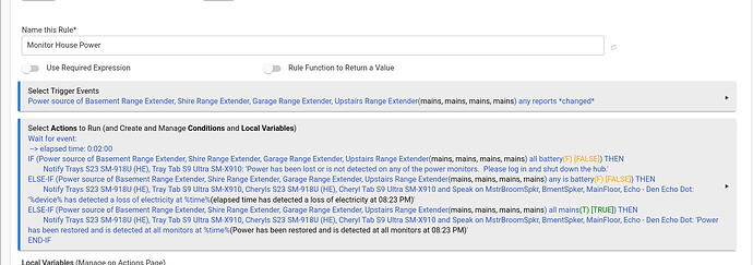

I do have one rule for power failure that relies on ring range extenders changing from line power to battery. That one also runs on "changed" and is guaranteed to be in a different state from when the hub is rebooted after a power outage. It isn't paused, the hub is usually off when the power resumes and doesn't finish booting until after all the power is restored (95% of the time) Never had issues with it detecting changed states in that situation.
I get notification of a power outage
I wait 30 minutes, if the power isn't back, I shut down the hub (it is on a UPS)
Power comes back on
Hub takes a few minutes to reboot (in the mean time, the extenders have ALL switched back from battery to line)
Next outtage is detected as normal.
Fortunately (tongue in cheek), power unreliability of late is reliable enough to use as a practical test for this. With the storms we have had of late, I have had SEVERAL power outages over the past month.

So, if the bug is there, it appears to ONLY be on the actual "pause/resume" cycle.

Created a rule with trigger changed to log %device% changed to %value%
Verified logging of switch change
Paused rule
changed switch
resumed rule
changed switch - no log entry
changed swicht again - log entry
Pretty cut and dry

Log shows app and trigger device
Using required expression solves the issue
