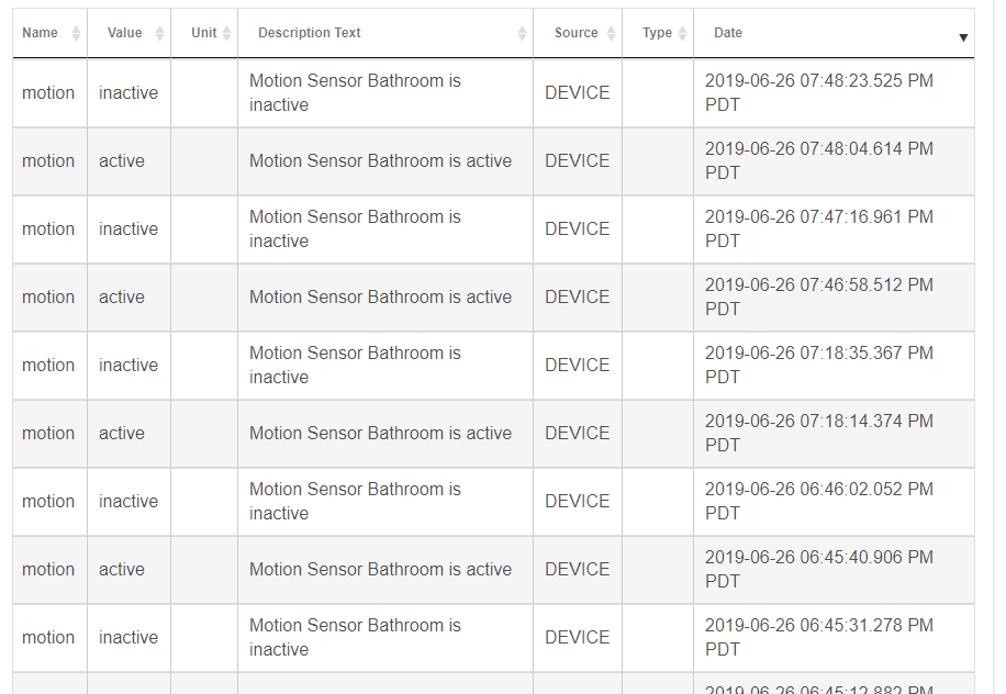

Device events show motion sensor changes state from active to inactive back to active when motion is detected, but the rule still doesn't fire !

Device detects "Active" but app does not. Though, it did once, as you will see in the list, but didn't fire the rule.
