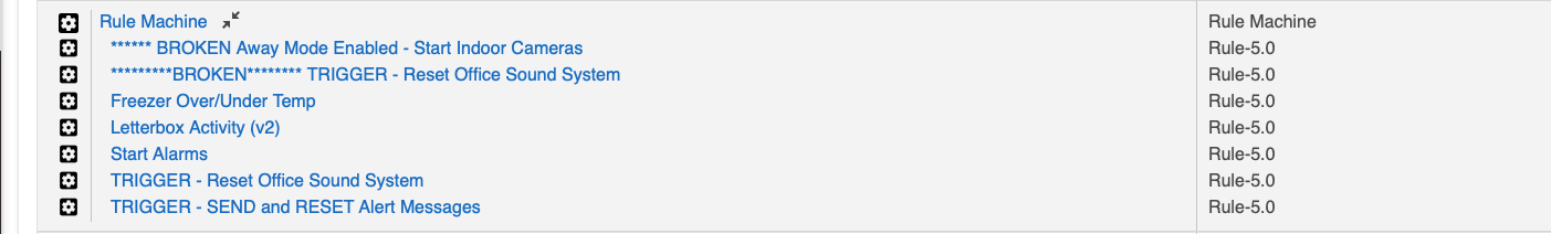

Regarding Paused not showing in App List for RM5 Rules.
I have tested on the 6 Rules I created, I opened the Rule pressed Paused, the Red Paused appears at the top of the Rule.
Pressed (from memory) Done
I would expect the word Paused in red appended to end of the Rule name.
All 6 rules Paused, none currently showing as Paused in App List, all checked and confirmed showing as Paused.
I did have one, just one, that did show as Paused but did not remain for long until it was gone.

Please explain in more detail. The red Paused appeared at the top of the page, and then you hit Done, You didn't see Paused on the rule name in the Apps list, right? Did you try refreshing that page? Was it still on the top of the app page when you opened the app again?
It’s late here
See the images at the beginning of the thread.
I have not tried refreshing screen because I have been moving between, settings, apps, devices, would expect it to update then?
Just opened Apps on this iPad, and 4 of the 6 paused rules are showing as paused.
Going from some other page to Apps page is the equivalent of refreshing the page (not a dynamic page). If you open one of those two apps that do not show Paused, do they still say Paused at the top of their app page?
Yes
Just so you know, the way this works is that the Rule actually changes its own name to include the red text '(Paused)'. The Rule does not cause the display of its name in white text in the black border of the top of the page -- the platform does that. If the name of the Rule with the Paused in red does not show up in the Apps list page, but it does show up in the Rule itself, this is most likely a browser cache issue, where the prior page, without (Paused) as part of the name, is being displayed. Usually a page refresh will cure this (or clear your cache -- with Chrome I've never seen this happen). This is also not something that the code of the Rule does, but again the platform. (So don't go blaming the "stability" of Rule 5.0.)

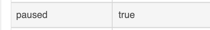

You can always verify the actual state of paused by examining the App Status page. In the Application State it will show this:
The implementation of Paused has not really changed since it was introduced perhaps two years ago. The cosmetic issue I alluded to before has to do with the interplay between (Predicate False) in red, (Repeating) in amber, and (Paused) in red -- each of which may occur. But, you didn't report that (Predicate False) was being displayed instead of (Paused), and I don't see how this could happen as Predicate Condition checking is also paused when the rule is Paused.
