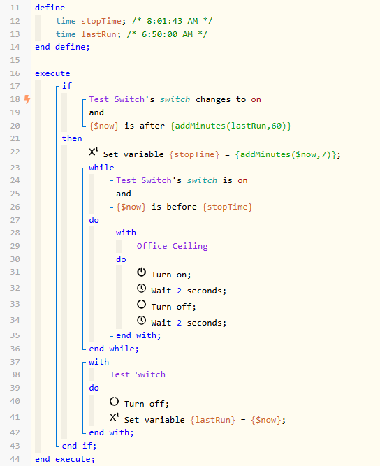

I honestly hate Rule Machine logic. This is how you can do it in Webcore. Note that Webcore reads very much like your 5 steps.
Edit: I would be happy to help you write this rule in Webcore if you chose to. Some of the things there, like adding the addMinutes() method in an expression, may not be clear for new users.

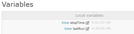

Also, you will need to seed the lastRun time for the very first run, by setting it in the Variables section of the piston page by clinking on the edit button, and setting a time greater than an hour before present time.

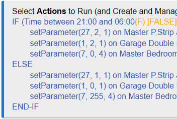

If they do then do they support parameters for the flash function? If they do, you could update the parameter for rate and what else then send the flash command and be good for a while. Every thing we are able to off load is a win.
Agreed!
There is one possible way to do it if one uses all Zigbee devices (directly paired to the hub). One can create a Group of Zigbee devices, enable Zigbee Group Messaging, and then use the Group Device to control them all at once without the popcorn effect.
While the Hubitat Flash Capability states that an optional parameter is available, none of the device drivers that I use support passing in that parameter. :man_shrugging:
Update: It appears you're referring to changing/setting Z-Wave device parameters programmatically, correct? If so, that would be very device dependent. I do not use any Z-Wave devices these days, so I can't be much help there. :wink:
