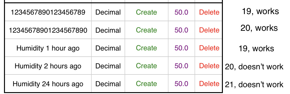

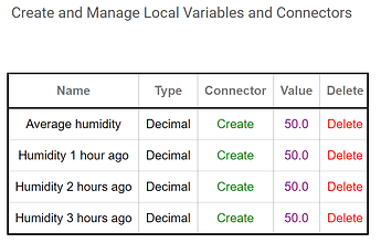

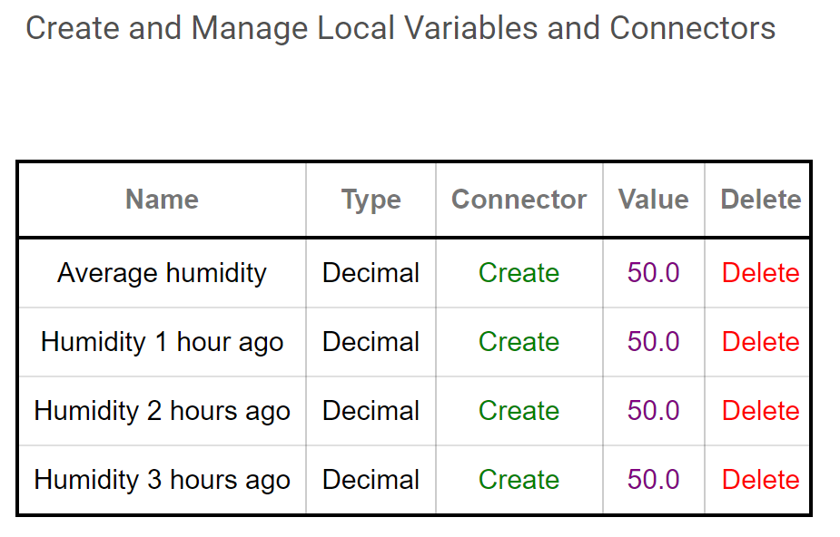

I have identified an issue when using local variables that have names longer than 19 characters in Rule 5.0. I created the following local variables:
The name of the last two variables are 20 characters whereas the first two have names of 19 characters or below. Other than their name, they are identical as you can see in the screenshot.

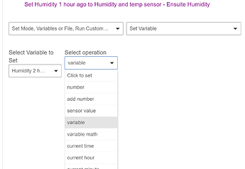

The issue I'm running in to is that I cannot use "Set Variable" with the 20 character variables.
It doesn't matter what I select in the "Select operation" drop down menu. Nothing happens when I click it and it doesn't even "close" the drop down menu when I click on something in it.

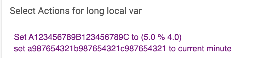

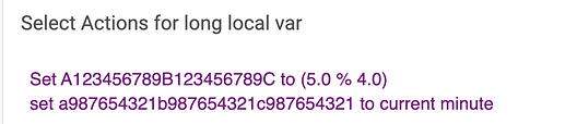

I can confirm this issue as well in a test case using Chrome. 20 characters or less work just fine. Anything over 20 does not allow the completion of the action. @mattias I think I got it to work as a workaround by doing the following:
Select the long variable name. Choose the Operation such as Number. Click outside of the dropdown and then click the Refresh button. Once I did that, it allowed me to set a number. I didn't test to see if the rule actually worked using that method, so you may try it.
I also created a few different variables to see if it mattered for number or decimal, etc. It didn't.
