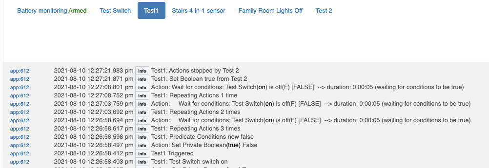

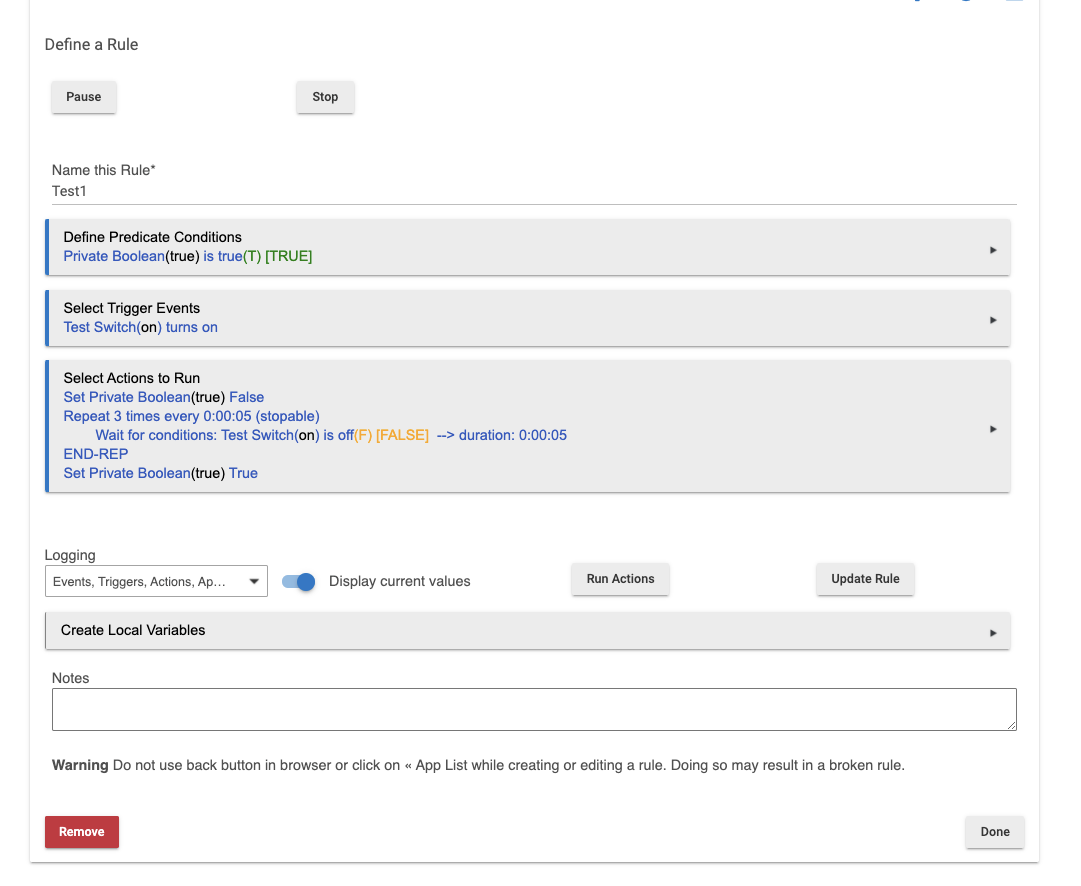

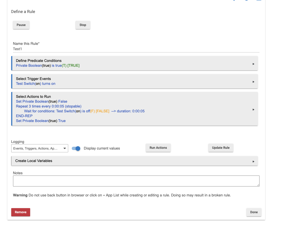

Here is a stripped down version of my actual rule:

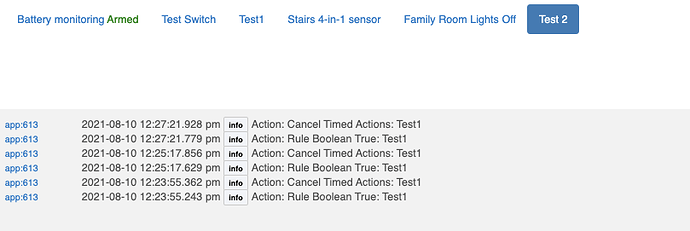

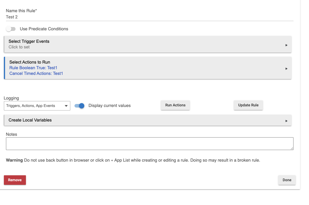

Here is the secondary rule:

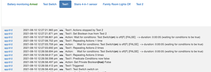

Initially when the trigger event occurs the rule (app:612) executes OK and is stopped by the secondary rule executing:

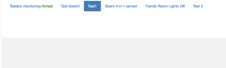

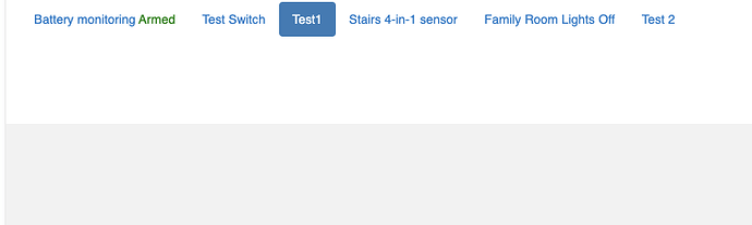

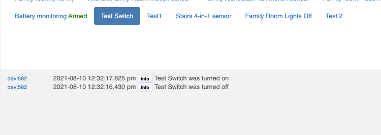

After this occurs, the trigger event (switch dev:582) no longer fires the rule:
There is nothing in the logs for app:612:
Even though the Predicate Condition appears to be true:

Yeah, there is some interaction going on with Wait for Conditions and the Predicate Conditions working properly. I will look into further.
I have found this bug, and put in a fix for it. The fix will be in the 2.2.9 release. It is caused by the Wait for Conditions.
