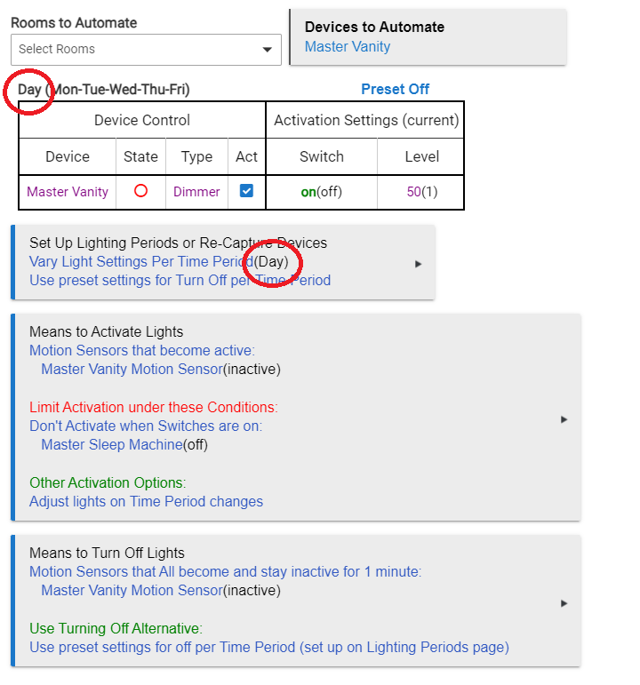

Heres a perfect example. You can see on top ot shows evening 2 but it should be in the night time period.
Toward the bottom in the box it shows night as the period.
Gotta be a bug
I seem to have gotten it working by deleting and recreating it, but I had done that yesterday and it didn't work. Maybe theres a certain order of things during creation that confuses it. Who knows. Would love to see the labels come back tho.
This picture is not a bug; though, I would need to see the logs to confirm. The top circle shows that Room Lighting turned off in Evening 2 and went into Preset Off settings for that time period. The second circle shows that when Room Lighting gets activated again, it will move into the Night time period. Once the light gets activated again, it will shift into Preset Off for the Night time period when Room Lighting gets turned off.

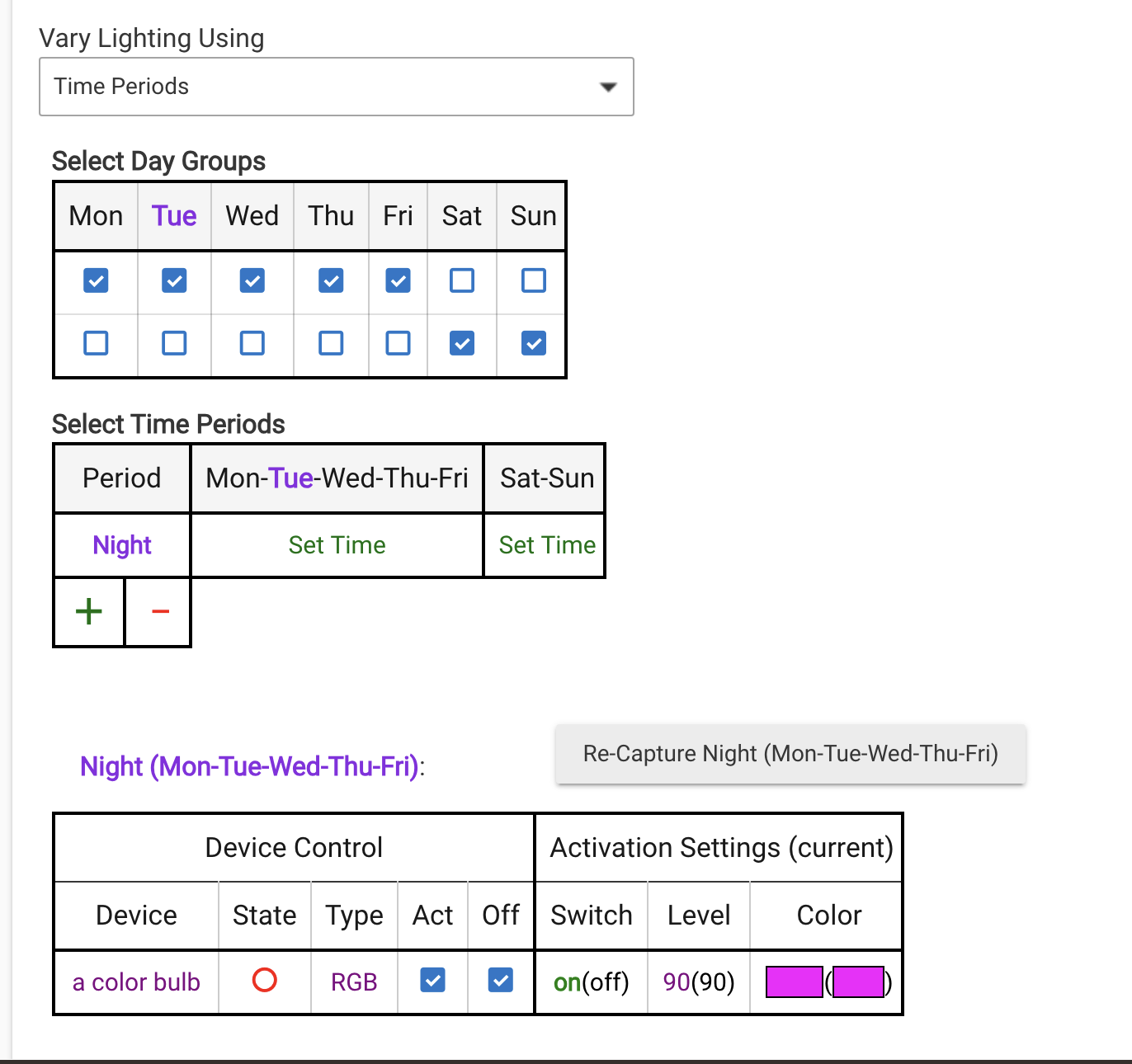

When they work, they match up though. Here's a screenshot of it working after I deleted and recreated it.
I don't know how you got to those settings. I need to see the entire screen.
I don't know what steps you did to 'break' it. Without something I can replicate, it's not possible to diagnose the issue. I cannot reproduce what you showed above.
When I select the option for Preset Off per Time period in the Means to turn off the lights, when I go into the time period page, there are no headers to indicate which Preset Off goes with which time period. Does the pictures with the circles help?
OK, I can reproduce this. Will find the cause and get it fixed...
Fix for this will be in the next release.
