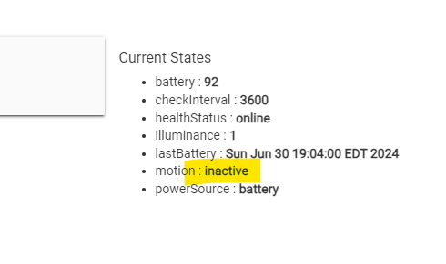

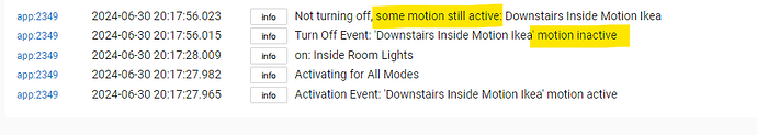

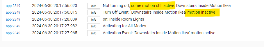

This rule has worked for almost two years. I just swapped to a different motion sensor and now it won't turn off. It shows the motion is inactive in the log, but says it "some motion still active" (even though there is only one motion on the rule). When I go to the device page, it shows that the motion is inactive. Any suggestions?

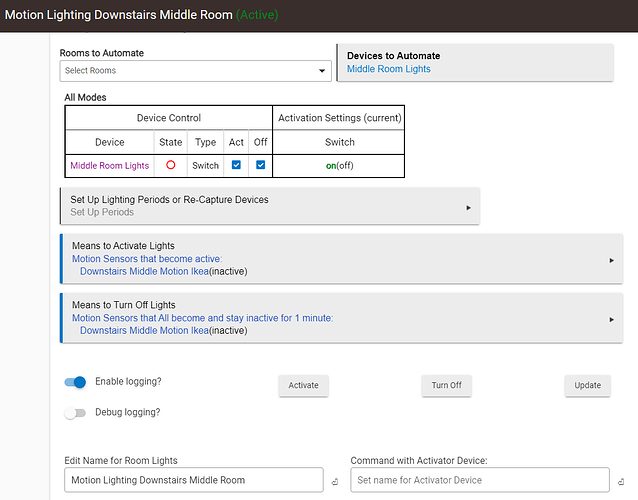

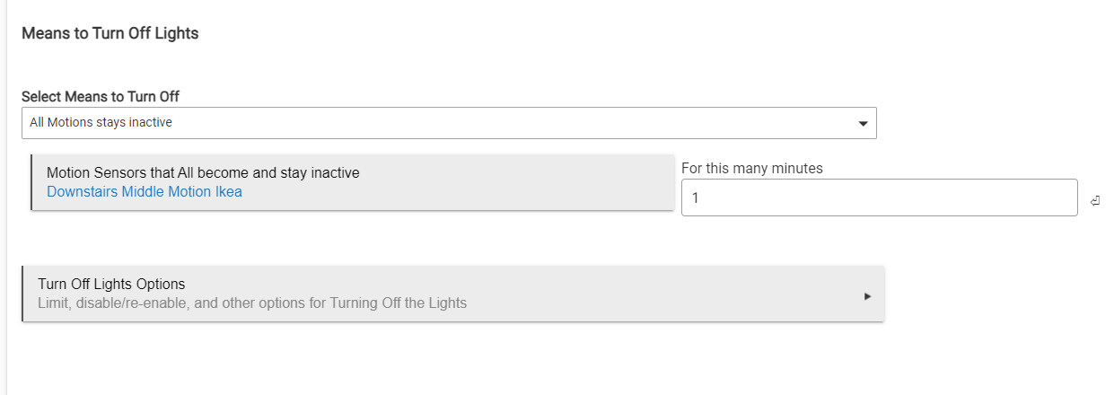

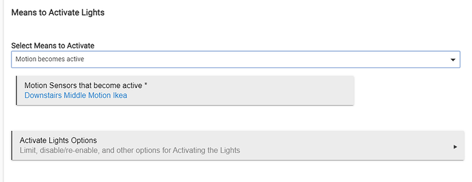

I would suggest you remove that instance of Room Lights, and recreate it. If it does the same thing, post again.
I deleted two room lighting rules that were not working. One now works as it should. The second is still showing inactive, but saying it's active and not turning off.
Thanks! We are looking into this. Seems as though some change in the current release might have caused this. What platform version are you on?
