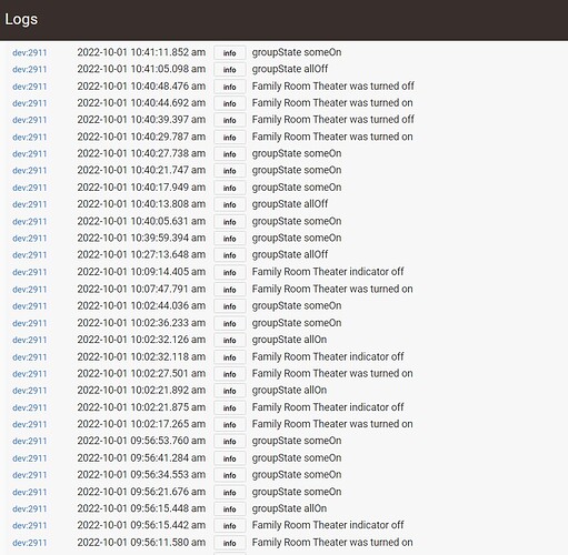

I have a similar issue, as my motion activated light scene has been sporadic, I have 2 motion(Iris model: 3326-L) sensors to trigger a light switch(GE dimmer 14295) it worked great prior to the last few updates.
