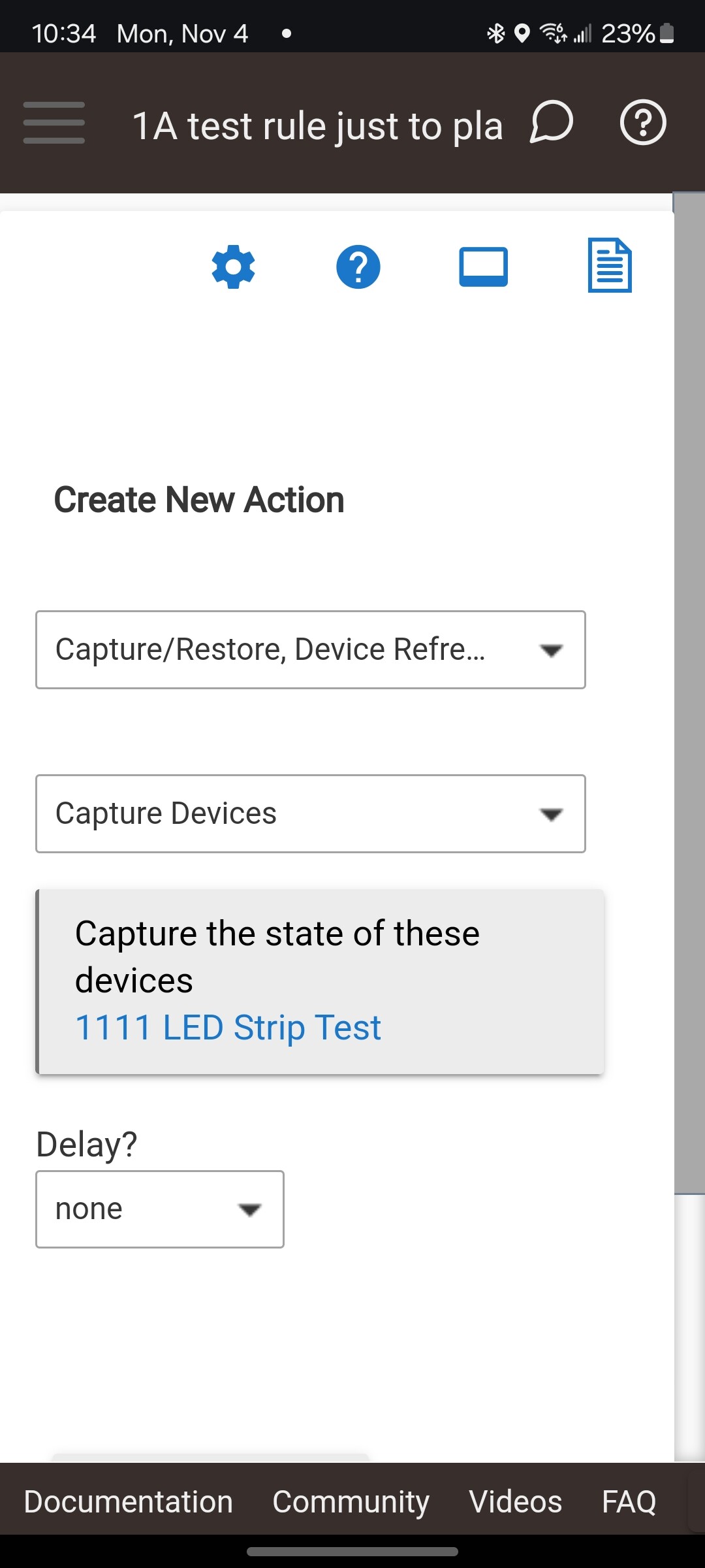

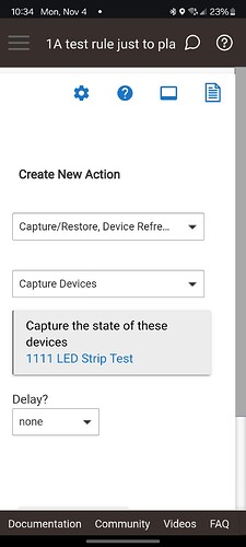

You might have to use Rule Machine instead of Room Lighting, as RM has the option to save a color before it is changed. I don’t believe RL has such an option.
As James notes, this may require Rule Machine... And its Capture and Restore capability.
You can capture (save) a device's state, change its state, and then restore its saved state.
So your LED lights are blue, you walk in the room and their state is captured. Then the LED changes to white so you can see, and when you leave the room the LED strip (and any other devices you captured) can be restored to their saved state (In this example the LED strip returns to blue).
