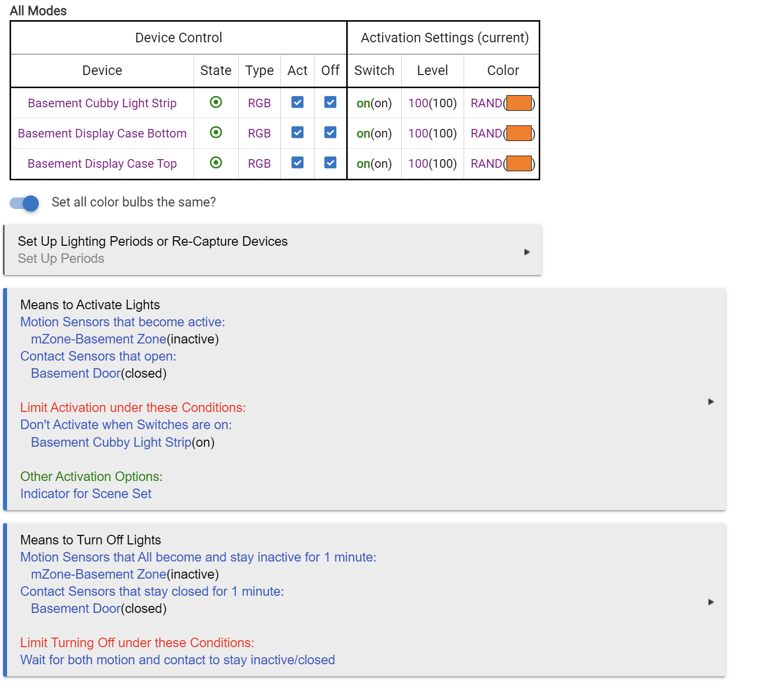

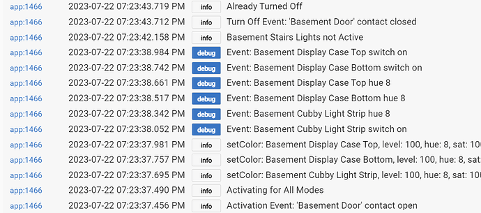

I have a simple room lighting app that turns on 3 lights to a color and off when motion stops and a door stays closed. It doesn't seem to be turning the lights off anymore after I changed the activation color from blue to random. The scene indicator no longer says "active". The logs say its "already turned off", but according to the app's own activation chart, its clearly on.
Note this only happens when the color is set to random:
When its set to turn on the lights blue, the rule works as expected:
Edit: I also have it set to not activate if one of the lights is already on because when it's set to random, it will reactivate every time it detects motion and change the color of the lights too much, instead of only turning on to a new color on the first activation. Not sure if that's expected behavior here.

This works fine for me as expected. I suspect this might have something to do with the driver, but I don't know what.

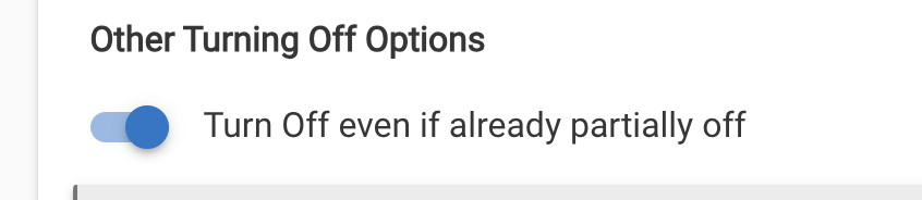

You could turn on this option in Turn Off Lights Options:
That will effectively force an off command, overcoming the "Already Turned Off" you have in your logs.
