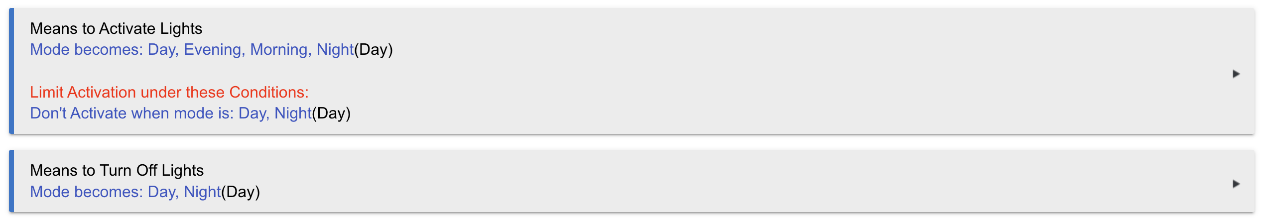

I have stuck with using Modes but instead of only selecting two modes, I selected all the modes that cover the whole day:
I'm only interested in lighting in the morning and evening modes, so I configured the day mode like this:

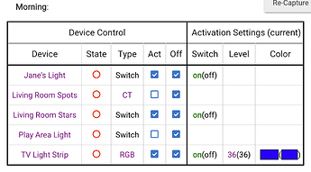

For reference, the morning mode looks like this:
I then setup the Means to Activate and Means to Turn Off like this:
This change seems to resolve the issue. When the mode changes from Morning -> Day, the turn off event is triggered for the Morning period and no activation event happens for the Day period.
