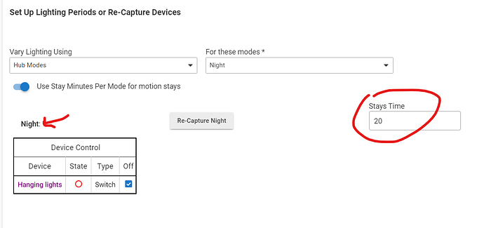

I am trying to configure a light, so that it turns off, if there is no activity for 20 minutes, and it is between 12 am to around 5 am. But, when I select "night" mode, it keeps changing to "early morning" mode for some reason. Any thoughts on what might be happening here?
You can see i selected night mode and 20 minutes

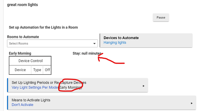

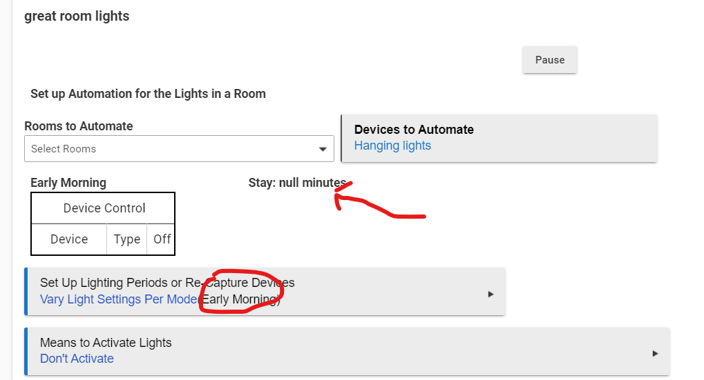

Got changed to 'early morning' mode with missing minutes.
Did you configure anything for Early Morning mode? What you've circled in the second screenshot (in parentheses) just shows you the current mode, i.e., what the app would do right now based on your hub's state.
oh i see, about the parenthesis part. Did not realize it is just showing current mode.
but, i have not configured anything for 'early morning'. Why is the area with red arrow showing 'early morning' and null as stay minutes?

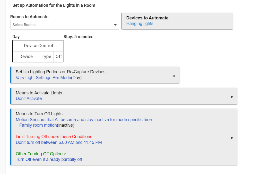

The OP is trying to set up a vacancy app instance. Under "Means to Activate Lights" the OP has chosen "Don't Activate". That can work, but requires the "Turn Off even if already partially off" option to be chosen. If the 'partially off' option is not chosen the lights won't turn off as the app believes the lights are already off. The vacancy/don't activate functionality is in the Room Lighting documentation, but it does not include the necessity to choose the 'partially off' setting. @bravenel @bertabcd1234
There are other ways of setting up a vacancy app, and I'll show that in another reply.

I duplicated the issue. It's easy to see when the logs are turned on. The "don't turn off between two times" keeps any 'off' actions from being scheduled while in the restricted time even if the 'off' is outside the restricted time. I'm not sure if that works as intended. @bravenel
It is true that the inactive event will not lead to the lights being turned off if it happens during the restricted period, even if there is a delay for turning off that would push beyond that period. But the posted Room Lights instance does not have a delay.
Ah, I see where I made a mistake in my testing.
@saurabh9 the mistake I made would take more time to investigate. Make sure to turn logging on whey you are trying to replicate. I'm pretty sure you will see where the issue is.
Having said that, I think the way to get the app to work as you intend is to delete the don't turn off between 2 times and to only use the 'Vary lighting using' options to set the operating times. You don't need to use modes, you can use arbitrary periods. (I'm assuming this app is only being used to turn off the lights between 11:45 and 5:00.)
You could always just use Rule Machine if the goal is to only turn off the light. If you are not using modes to adjust the lighting in any other way, a simple conditional action would suffice for your needs.
This obviously has my stuff. You could also write with a required expression of the time period and get rid of the conditional.
