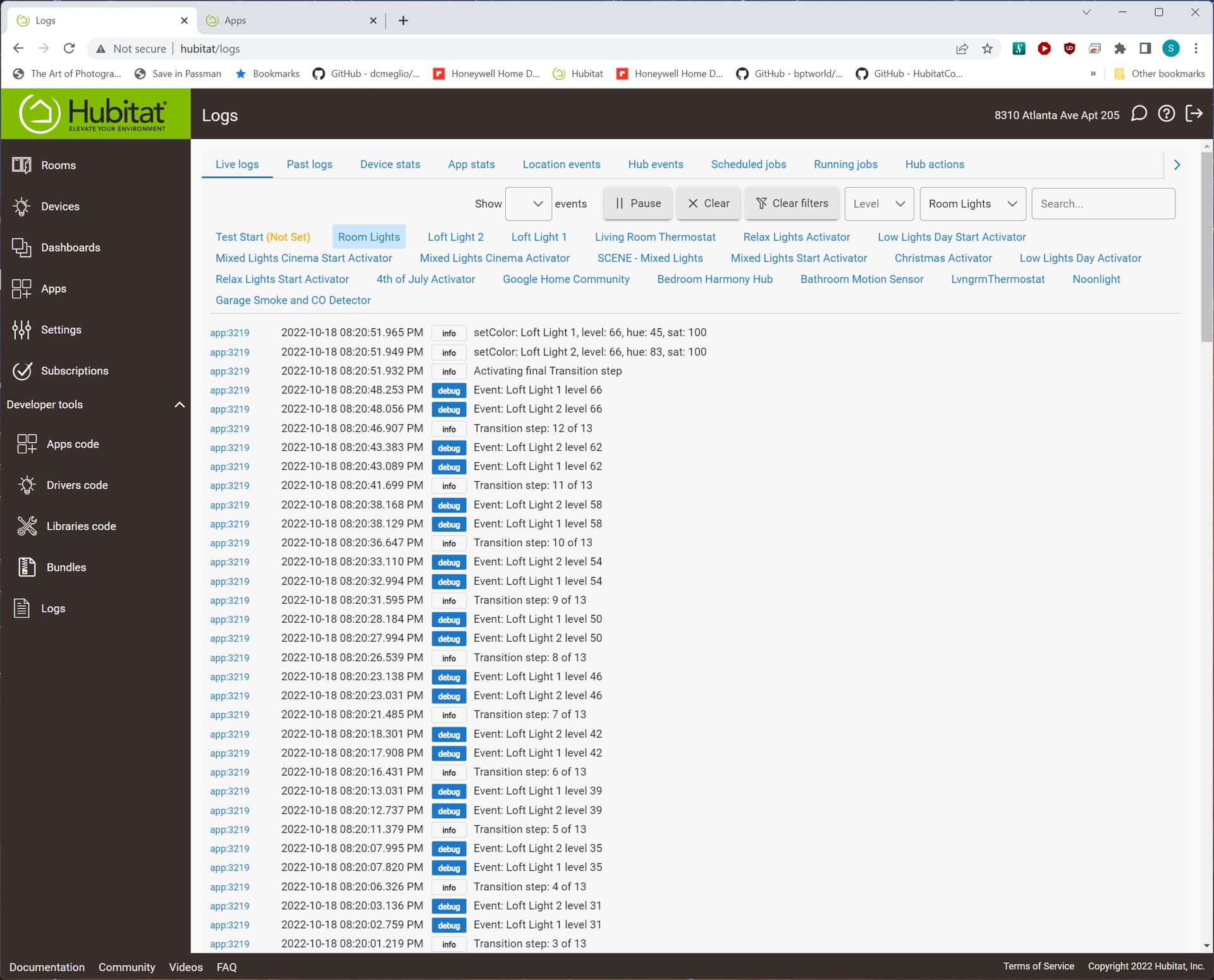

I can see in the log that the setLevel command is being sent as expected, but setColor is not being sent until the very last stage creating a harsh flip in color. Under the previous Scenes and Transitions, the transition would slowly transition the colors from the old color to the new color (along with level), creating a nice light show along the way.

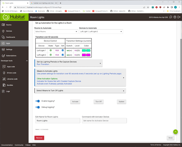

As I am new to the Room Lights app, I don't know if I have the settings correct or not? Please let me know what I am doing wrong here. Right now I just have this set up for testing purposes, so I have not set an activations apart from the transition itself.
Here is a shot of the app:
Here is a shot of the log:

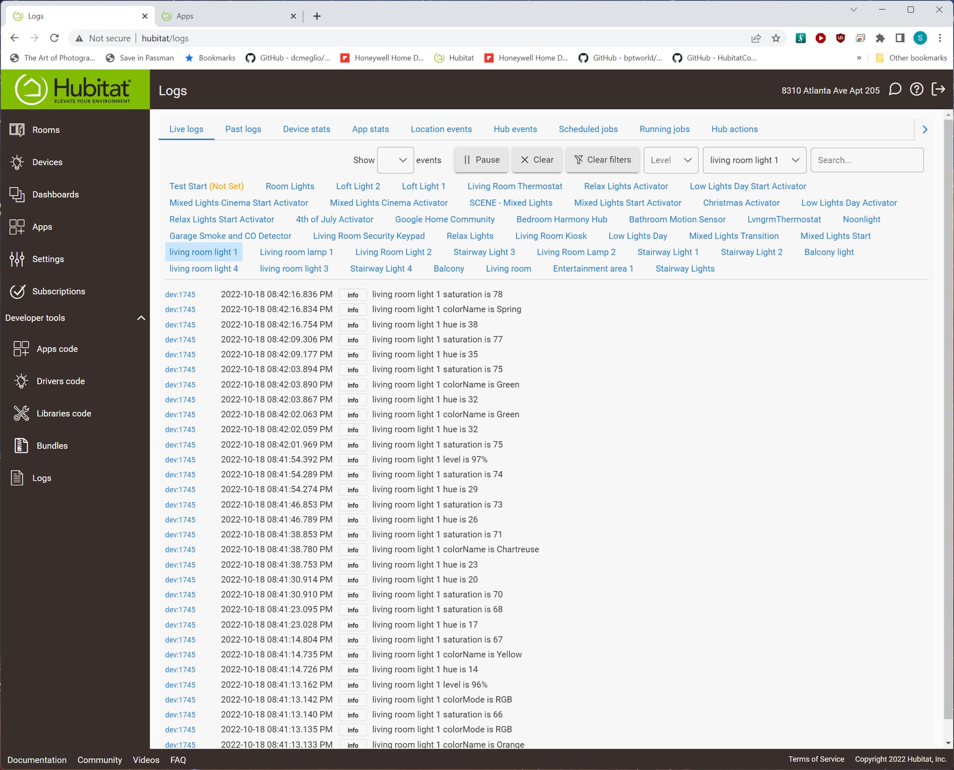

Here is a shot of the log for one device using the original Scenes and Transitions showing what I intended to happen:
Ahhh nevermind, I figured it out. Even though I was using a capture device and it was capturing lights that were in the RGB state, the initial state of the lights in period control was still set to CT. Apparently even though the lights were in the correct RGB state, it still needs to be set correctly in the app or else it will not send HSL commands to change the state from CT to RGB until the very last stage. At least I think that is what is going on.
