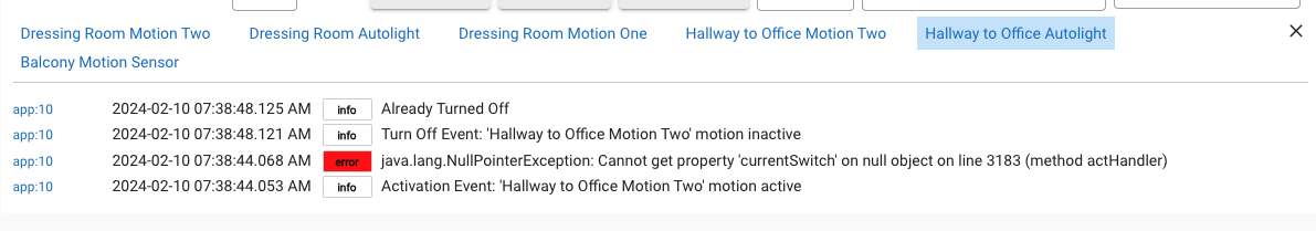

I changed nothing and all of a sudden my Room Lights app is giving me this error, which prevents it from turning on the lights:

Sure... Here is the error:

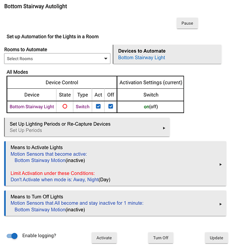

Here is the rule:

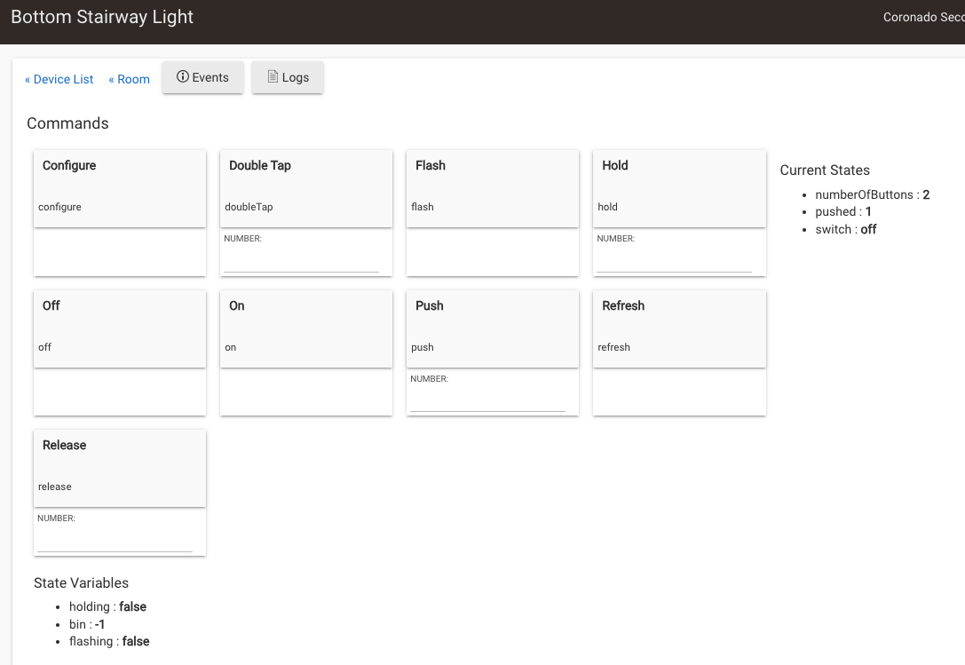

And here is the device - Bottom Stairway Light:
All three appear to be there. A rewritten rule using the exact same device works fine.

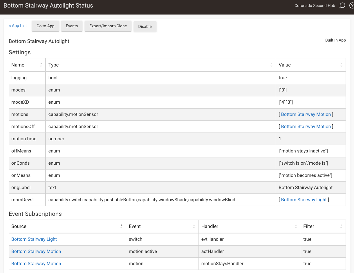

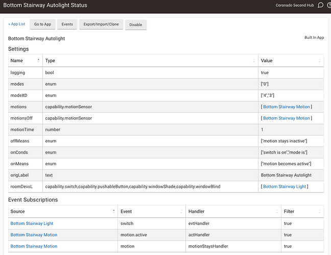

And here is the "gear" info for the Room Lighting sub-app:
Ah, good. So perhaps this was some corruption of your database.
